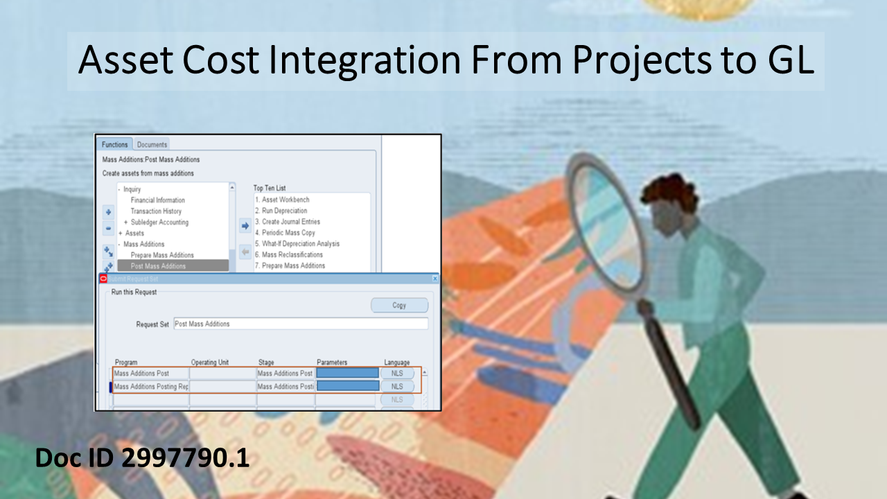

Latest Release: Mastering Asset Cost Integration – From Project to General Ledger
Discover efficient Asset Cost integration from Project to General Ledger Modules. Our new document offers key insights on setups and best practices, detailed in Doc ID 2997790.1. https://bit.ly/3vTgHG7
#OracleEBS #ProjectCosting #Assets
