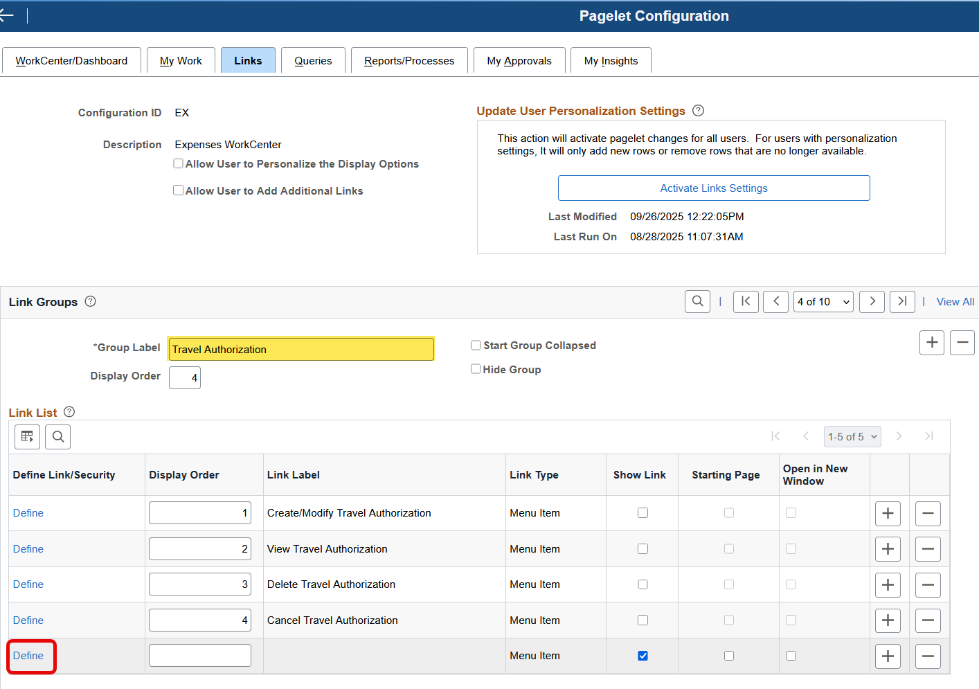

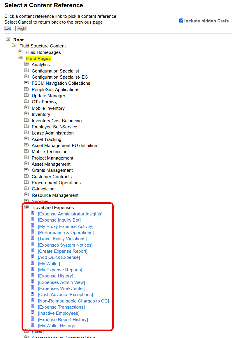

We are looking into implementing the fluid expenses workcenter. When trying to add a new link to the Links tab on the Configure Pagelet page using the Link Type of Menu Item, under the fluid pages path through the Travel and Expenses folder I do not see any links available for the fluid travel authorization. I think there should be a link to the fluid TA search page and fluid TA create page. It doesn't make sense to be able to add links for some pages and not all pages.
1.) Navigation: FSCM > Enterprise Components > WorkCenter/Dashboards > Configure Pagelets
2.) Search for Configuration ID "EX", then select the Links tab.

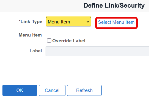

3.) Under the Group Label "Travel Authorization", add a new row and then click the Define link.
4.) Select a Link Type of Menu Item and then click on the Select Menu Item blue link.
5.) Fluid travel authorization pages are not listed under the fluid structure content.
