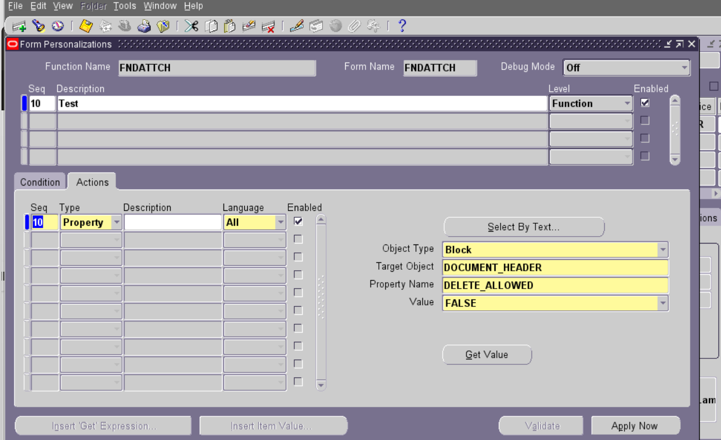

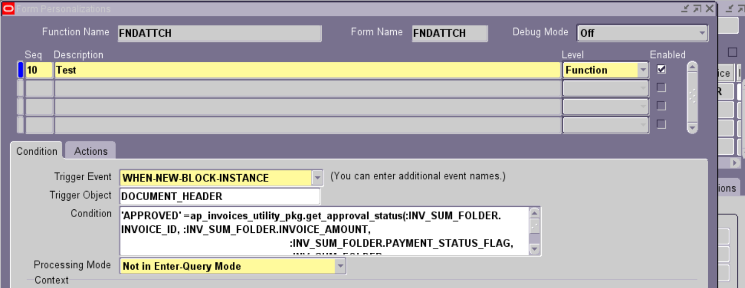

Re: Disable attachment delete option for Payables Invoice With Status = Validated
HI Sainath Reddy
Please find the below screen shots for your reference
'APPROVED' =ap_invoices_utility_pkg.get_approval_status(:INV_SUM_FOLDER.INVOICE_ID, :INV_SUM_FOLDER.INVOICE_AMOUNT,
:INV_SUM_FOLDER.PAYMENT_STATUS_FLAG,
:INV_SUM_FOLDER.INVOICE_TYPE_LOOKUP_CODE)
