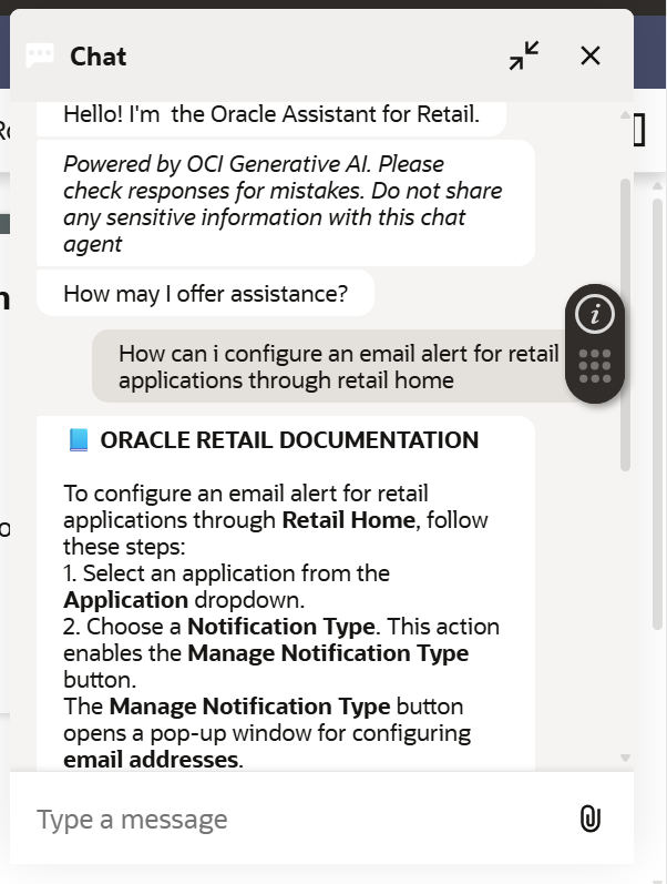

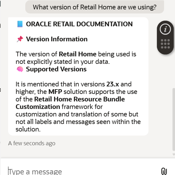

Re: RPASCE V25: configuring ODA in Planning Application
Hi Andreas,
I have already logged an SR for ODA in MFP.
"Customer needs to request for this feature to be set up."
The Client expectation about ODA is to assist business users on the real time. currently they are checking with the dev team regarding this. once i get more info i'll update here.
In Retail Home we are having an ODA (but haven't raised any SR to enable this ), ODA answers are more generic to retail questions.
Retail home version :25.1.301.0
use cases were mentioned for ODA in AIF:
