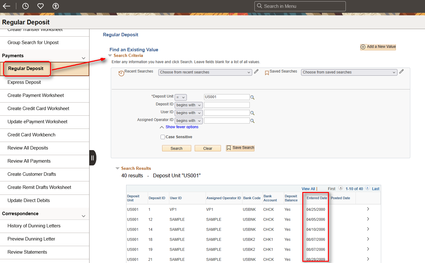

Having reviewed your comments, I am assuming that you are talking about the below Entered Date column:
Note that the Regular Deposit within the Links > Payments section from Fluid Receivables WorkCenter is basically pointing to the Regular Deposit search page under the below navigation path:
- Accounts Receivable > Payments > Online Payments > Regular Deposit
The Entered Date column has been listed in the search results for many releases now. Adding the Accounting Date, while a valid point, would be an Enhancement Request. I would suggest you raise this same post into the Receivables Ideas Lab site, so it can be considered by the Strategy and Development teams for future FSCM 9.2 PUM Images.
The Search Record behind the Regular Deposit page within the Component PAYMENT_ENTRY is based on DEPOSIT_NP_VW (Deposits - Not Posted). You will see the fields within this View include ENTRY_DT. If you wish to have the Accounting Date, you would need to customize this View to include/list ACCOUNTING_DT field as well.

When querying the AR Regular Deposits link of the Links> Online Payments section of the WorkCenter, the results include Entered Date. Would it be more beneficial to have Accounting Date instead, or have that field added to the delivered functionality?
