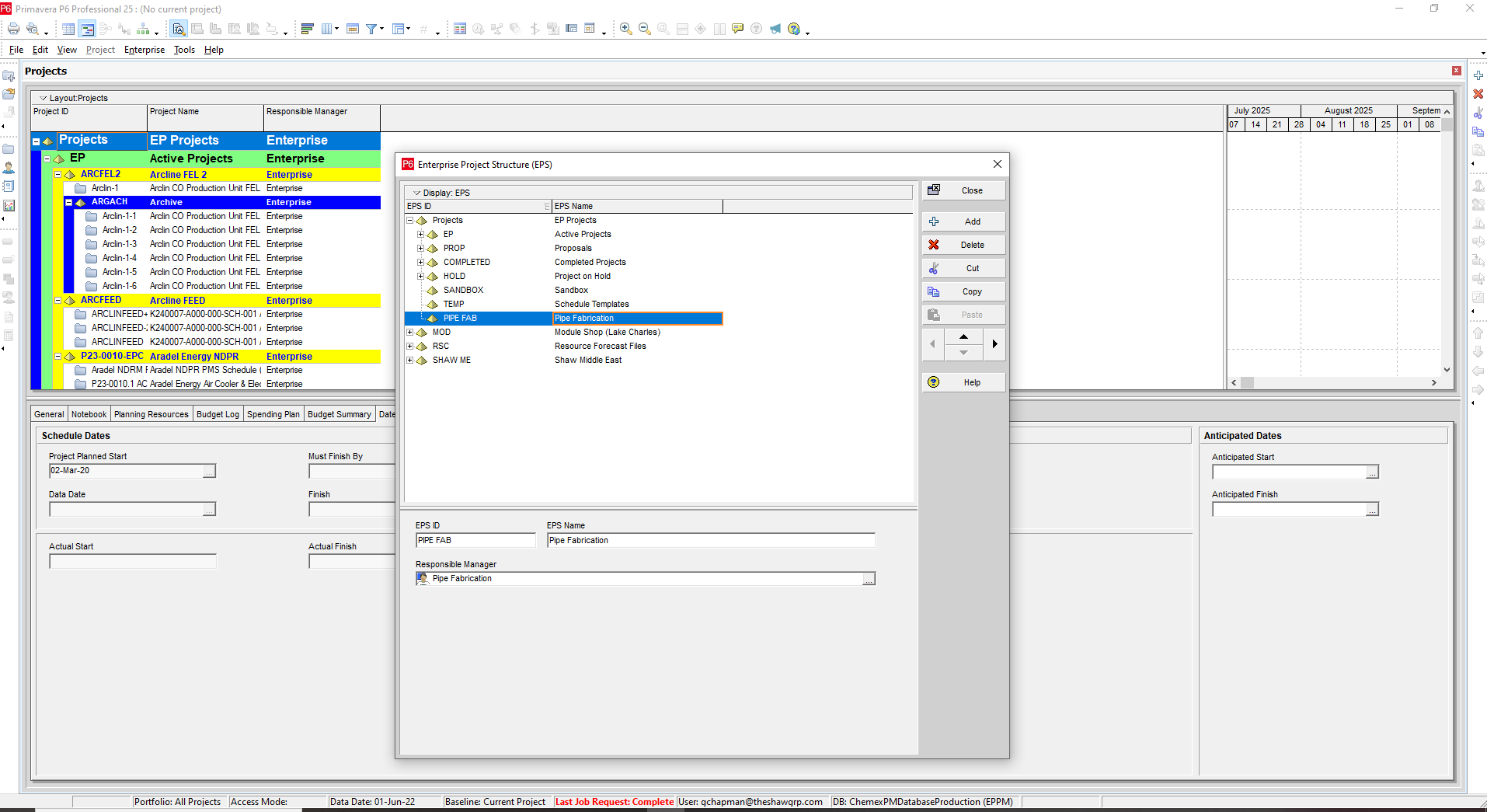

In the EPS I added Pipe Fabrication. I was in the Projects node when I did this. I added the responsible manager as pipe fabrication. It added it under the Projects node as a child. I need pipe fabrication to be independent of the other business units but I don't have the option to move Pipe Fab out of the Projects node to be it's own independent node. Pipe Fabrication is a different business unit just like the EP projects node, Module Shop node and the Middle East node.
How do I move the Pipe Fabrication to the left? This is what I did to begin with and I wasn't able to move it over to be it's own node. Then I Googled it and it sounded like I needed to create an OBS so I did. I can see that EP Projects, Module Shop, Resource Forecast Files & Shaw Middle East are all independent, so how do I make Pipe Fabrication independent?

Re: Created an OBS but it isn't showing up in my EPS. What am I doing incorrectly?
In the EPS screen the Pipe Fabrication is not showing up to add a responsible manager to. Is there another place to do this? Pipe Fabrication should be showing up above the Shaw Middle East OBS
