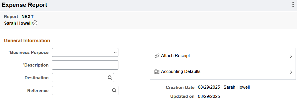

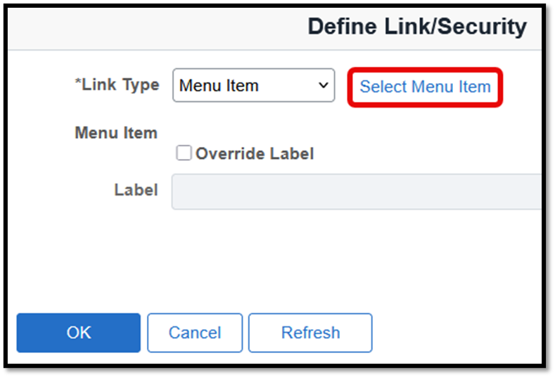

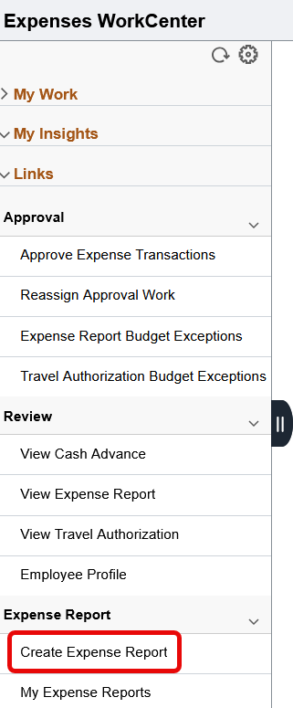

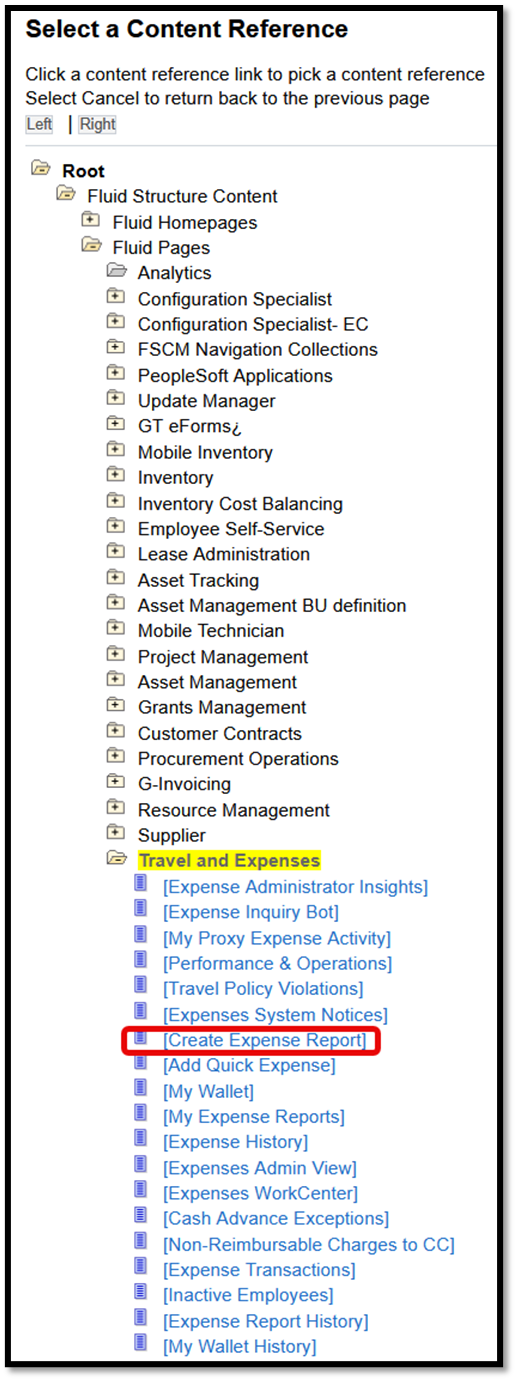

Hi Pere,
Correct on the fluid expense workcenter page I would like it to load in that space to the right of the grouplet list. On the Links page you showed in your screenshot I added a new line and clicked the Define link. I selected a Link Type of "Menu Item", then clicked Select Menu Item.
I selected the fluid Create Expense Report through this path: Root > Fluid Structure Content > Fluid Pages > Travel and Expenses > Create Expense Report (in our environment I had to select the "Include hidden Crefs" for the Fluid Structure Content folder to display).
I clicked the Activate Link Settings and saved. After navigating to the fluid Expense Workcenter the link shows up but when I click on it, the page does open but not within the workcenter. It appears to leave the workcenter and open the new page within the same browser tab/window, which is not the same as the other classic links where it remains within the workcenter allowing the user to stay on the workcenter page while they create their claim. The same thing happens on the My Expense Reports and My Wallet fluid page links.
