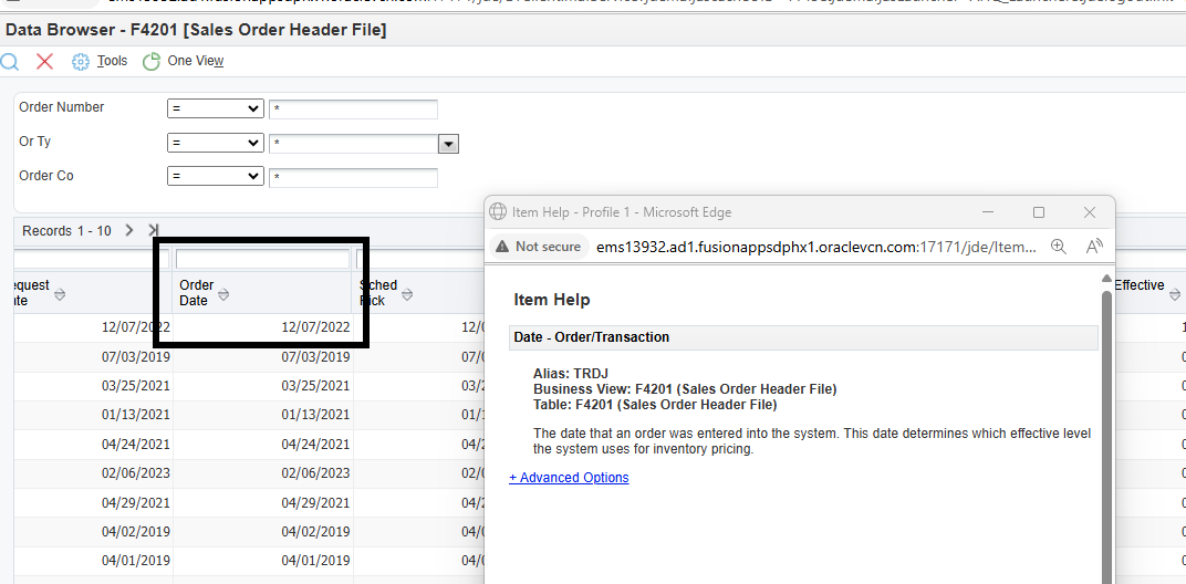

Re: Sales Order Header - Create Date
From Oracle Support: thank you for the post.
I think the field you are looking for is the Order Date, TRDJ…..please check and advise.
-Matt
