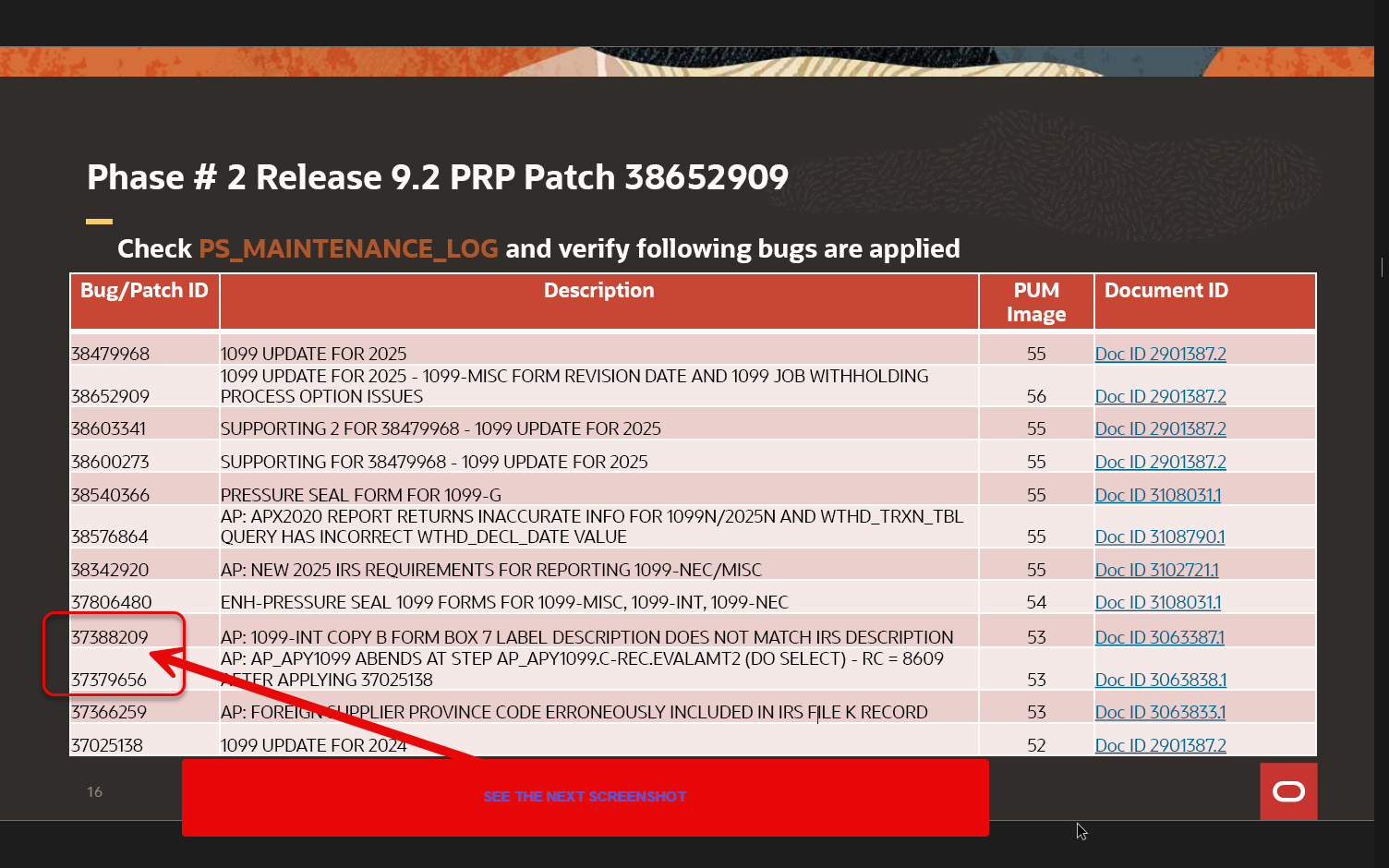

With reference to the presentation document "PeopleSoft_1099_Update_for_2025_-_Get_your_Copy_B’s_out_on_time_on_Nov_19_2025" the following screenshot says to verify bugs are applied

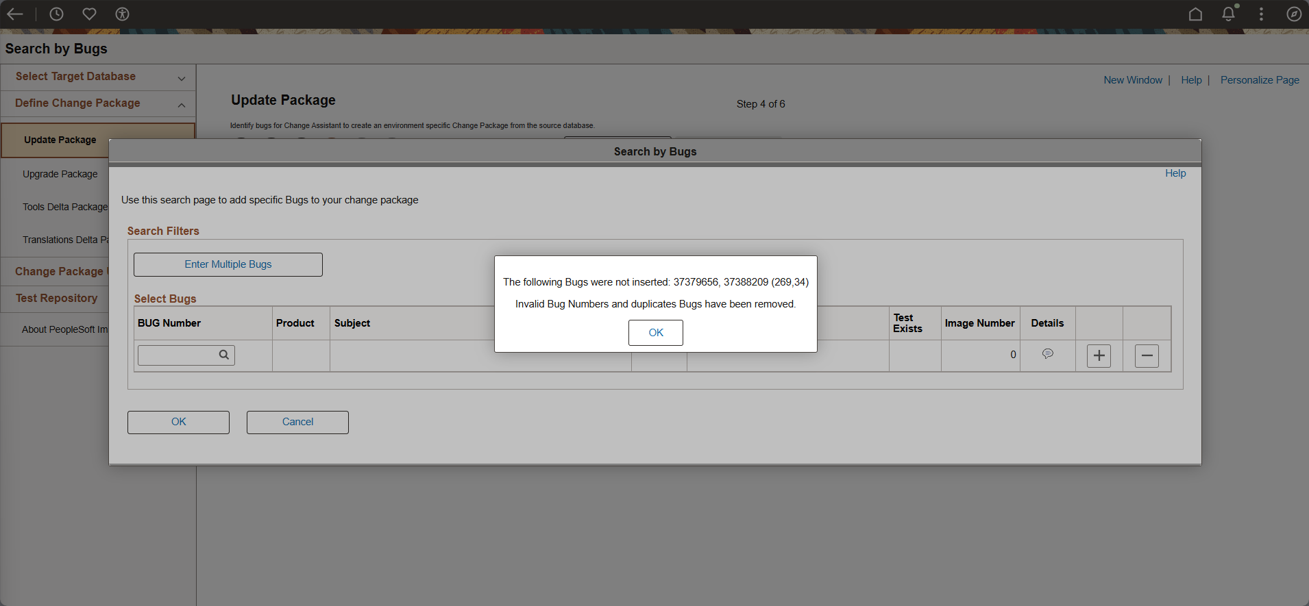

On checking the PS_MAINTENANCE_LOG for the above listed bugs (UPDATE_ID) 2 bugs 37379656,37388209 are missing (not applied). These are from PUM image 53. We have PUM Image 54, so when I try to create change package for these 2 bugs, I get the below message

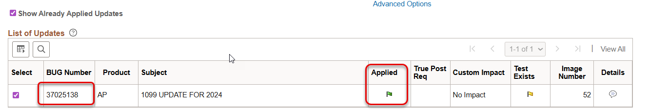

Also note:
Please clarify. There seems to be lot of confusion about what bugs are expected to be applied.
Thank you,
Francis

Hello,
The above issue was intermittent. When combined 3 bugs change package was successfully applied to other non-prod envs.
I ran 1099 Analyzer 200.5 after applying the change package based on bugs 3834292, 38652909, and 38662599. The change package review shows the following included bugs
37234282 ENH PSFTAP-8261 PRESSURE SEAL 1099 FORMS
37366259 FOREIGN SUPPLIER PROVINCE CODE ERRONEOUSLY INCLUDED IN IRS FILE K RECORD
37396293 SUPPORTING BUG FOR 37366259 - AP: FOREIGN SUPPLIER PROVENCE CODE ERRONEOUSLY INC
37806480 ENH - PRESSURE SEAL 1099 FORMS FOR 1099-MISC, 1099-INT, 1099-NEC
38342920 AP: NEW 2025 IRS REQUIREMENTS FOR REPORTING 1099-NEC/MISC
38479968 1099 UPDATE FOR 2025
38540366 PRESSURE SEAL FORM FOR 1099-G
38600273 SUPPORTING BUG FOR BUG 38479968 - 1099 UPDATE FOR 2025
38603341 SUPPORTING BUG 2 FOR BUG 38479968 - 1099 UPDATE FOR 2025
38652909 1099 UPDATE FOR 2025 - 1099-MISC FORM REVISION DATE AND 1099 JOB WITHHOLDING PRO
38662599 1099 UPDATE FOR 2025 - CFSF INDICATOR MISSING FROM THE IRS FILE FOR 1099-NEC
The Patch Verification shows Missing Patch
From Analyzer the Missing Patch
Bug 38603341 in in Patch 38652909 (see above, this already included in the change package)
The fix for Bug 37388209 has been incorporated into PRP Patch 37366259
The fix for Bug 37379656 has been incorporated into PRP Patch 37366259
Patch 37366259: AP: FOREIGN SUPPLIER PROVENCE CODE ERRONEOUSLY INCLUDED IN IRS FILE K RECORD shows This Patch is Obsolete. It cannot be Downloaded.
The only missing bug/patch is 38576864. Which I have downloaded and will be applying.
Can you please confirm?
Francis
