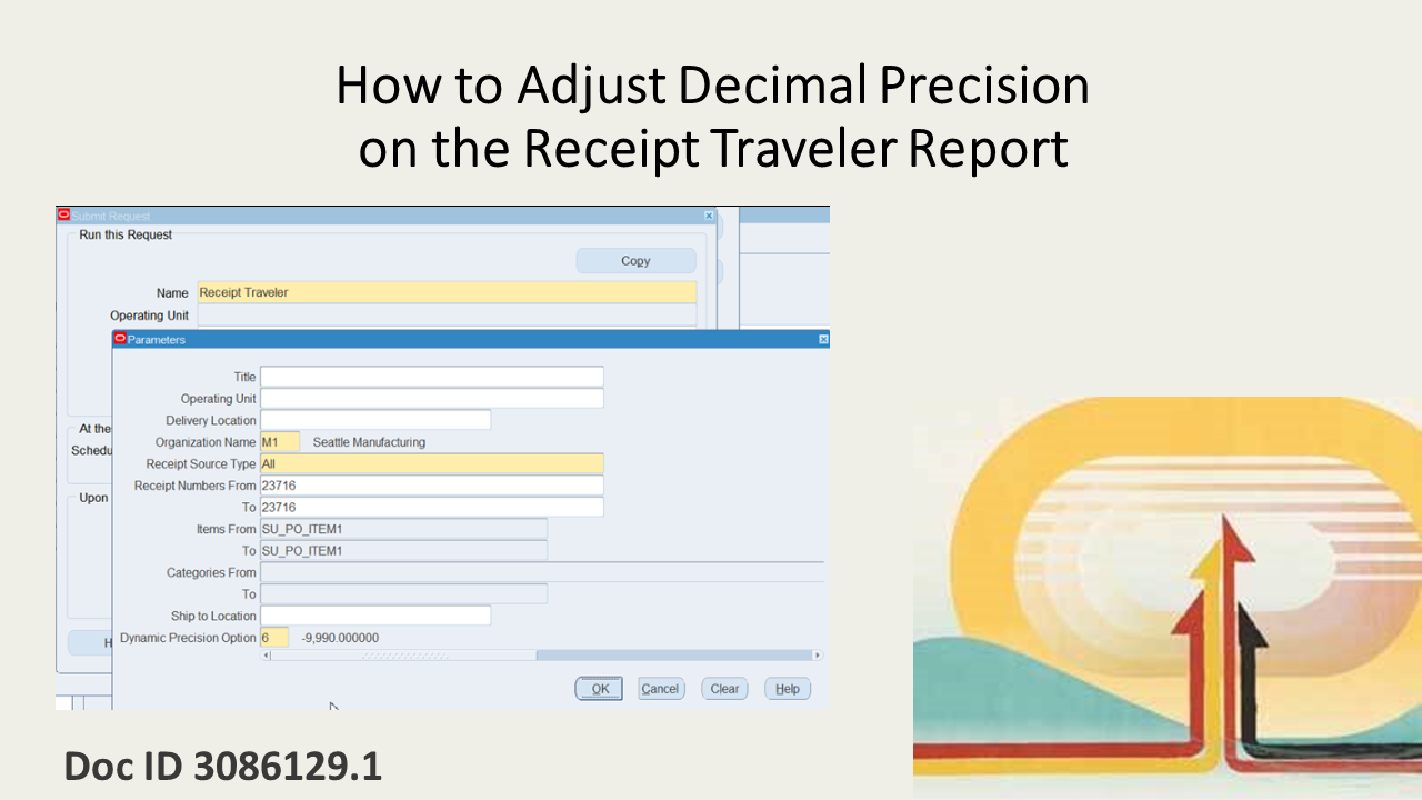

Control Decimal Precision on the Receipt Traveler XML Report
Learn how to configure decimal precision for quantity fields on XML reports such as the Receipt Traveler Report. Receipt Traveler Report can display up to 6 decimals (max). This can be adjusted as needed to display fewer decimals if needed. Doc ID 3086129.1.
