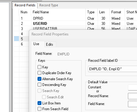

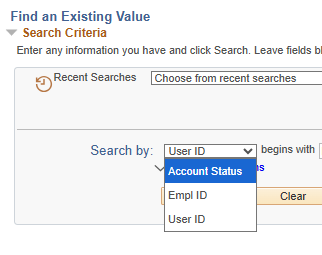

Hi - I tried in 8.61.11 to enable emplid as one of the alternate search key and it works good..
Are you trying something different?
Enabled Alternate search and list box
i see emplid as search
-Velu
