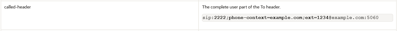

Re: REGEX translation-rules
Hi There,
@Antonio Scilimati - you are right, using uri-phone-number-only in HMR removes the symbols (eg. +, -, brackets) from a number before parsing.
The thing that confuses me here is that the called-header type in the translation-rules evaluates the entire header, not just the number. So I wouldn't have thought it should remove the symbols before parsing.
From the Config Guide:
As Monica suggests, I think it'd be worth opening a Service Request so we can take a closer look at what's happening here.
