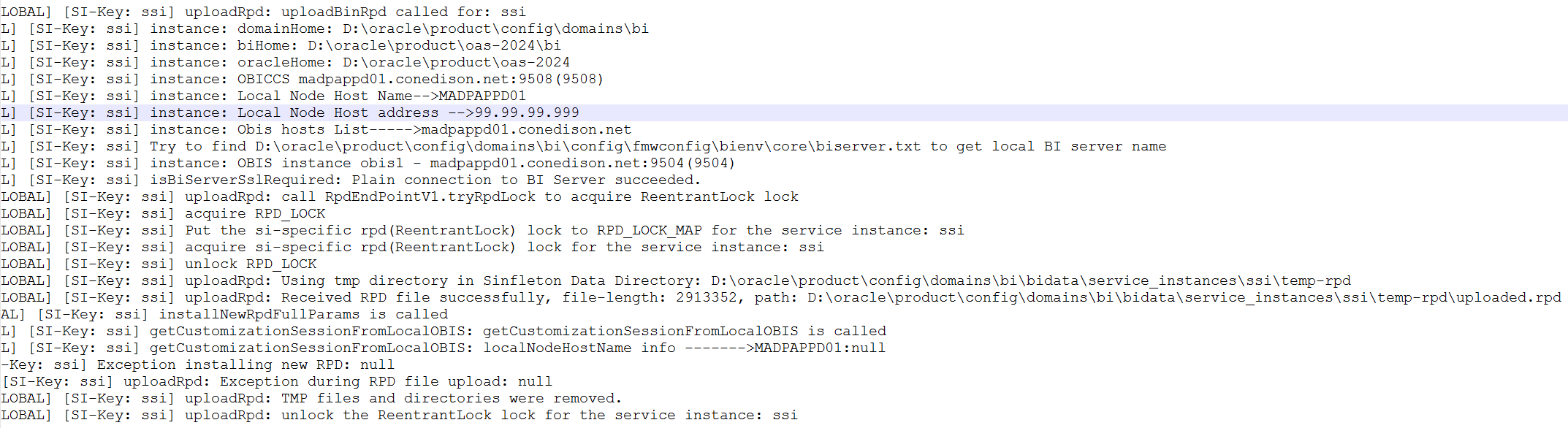

Below is the log from the bi-lcm-rest.log file
[2024-04-22T17:19:43.627-04:00] [bi_server1] [ERROR] [] [oracle.bi.lcm.pojo.si.rpd.RpdManager] [tid: 176] [userId: weblogic] [ecid: 8be4b265-db11-4d9b-9176-ee273cc71629-000004c0,0] [APP: bi-lcm-rest] [partition-name: DOMAIN] [tenant-name: GLOBAL] [SI-Key: ssi] Exception installing new RPD: null
[2024-04-22T17:19:43.628-04:00] [bi_server1] [ERROR] [] [oracle.bi.lcm.rest.si.rpd.RpdEndpointV1] [tid: 176] [userId: weblogic] [ecid: 8be4b265-db11-4d9b-9176-ee273cc71629-000004c0,0] [APP: bi-lcm-rest] [partition-name: DOMAIN] [tenant-name: GLOBAL] [SI-Key: ssi] uploadRpd: Exception during RPD file upload: null

[SI-Key: ssi] getCustomizationSessionFromLocalOBIS: localNodeHostName info ------->MADPAPPD01:null
[2024-04-25T14:39:43.627-04:00] [bi_server1] [ERROR] [] [oracle.bi.lcm.pojo.si.rpd.RpdManager] [tid: 176] [userId: weblogic] [ecid: 8be4b265-db11-4d9b-9176-ee273cc71629-000004c0,0] [APP: bi-lcm-rest] [partition-name: DOMAIN] [tenant-name: GLOBAL] [SI-Key: ssi] Exception installing new RPD: null
[2024-04-25T14:39:43.628-04:00] [bi_server1] [ERROR] [] [oracle.bi.lcm.rest.si.rpd.RpdEndpointV1] [tid: 176] [userId: weblogic] [ecid: 8be4b265-db11-4d9b-9176-ee273cc71629-000004c0,0] [APP: bi-lcm-rest] [partition-name: DOMAIN] [tenant-name: GLOBAL] [SI-Key: ssi] uploadRpd: Exception during RPD file upload: null0 -
