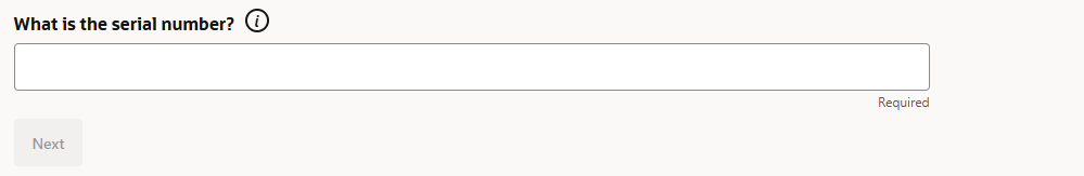

Re: support contract view
Hi @User_CYT2V ,
You should be able to select 'create service request' and raise an Oracle SR selecting the specific hardware (if you type "hardware" in which product or service the list will appear below)
and you can then ask to raise an SR. It will then ask you for the serial number:
Hopefully helps.
Kind Regards,
Rob
