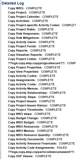

Re: Activity codes not transferring when copying project
David,
Thank you for your response. Here is some additional information on our issue:
*Yes - the codes checkbox is checked.
*We know they are not copying because the project will have a FEW lines of activity codes, but the remainder of the project has no codes. (ie. first 100 lines of codes are there, the remaining 7,000 lines are blank)
*We all definitely have the same access rights, otherwise we would get warnings that we do not have permission
To give a clearer picture, here is a snip of our Job Status Log

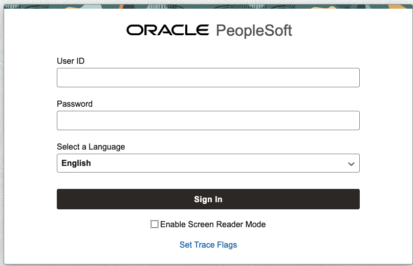

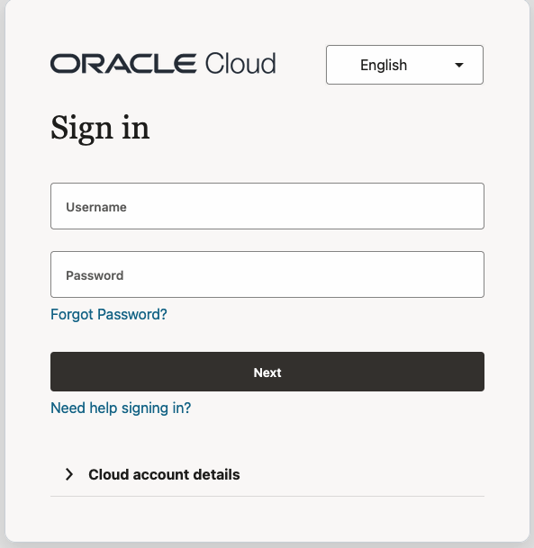

Hello,
Nicole here, I have searched internally with your corporate email and I couldn't find any SR raised, hence I cannot identify the product used. :(
So to help you, I can show what the login page for the HCM PeopleSoft Application looks like:
If you use Fusion Cloud applications, your logging page will look like this:
Please check and confirm which is the log in page used.
