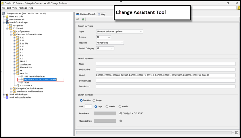

FYI - Install Change Assistant Tool (for Update Center)
If you have not already, I encourage all customers to download and install the Change Assistant Tool that connects to the Update Center.
I have used this tool for years as it has pre-defined queries for quick search. The year-end, as seen in the image below, holds all year-end objects and will give you all ESUs and the dates they were released.
I have attached a PPT showing the steps to install.
Regards,
TanyaM - Oracle
