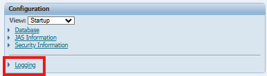

- In the navigation pane select Logging from the Configuration panel

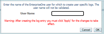

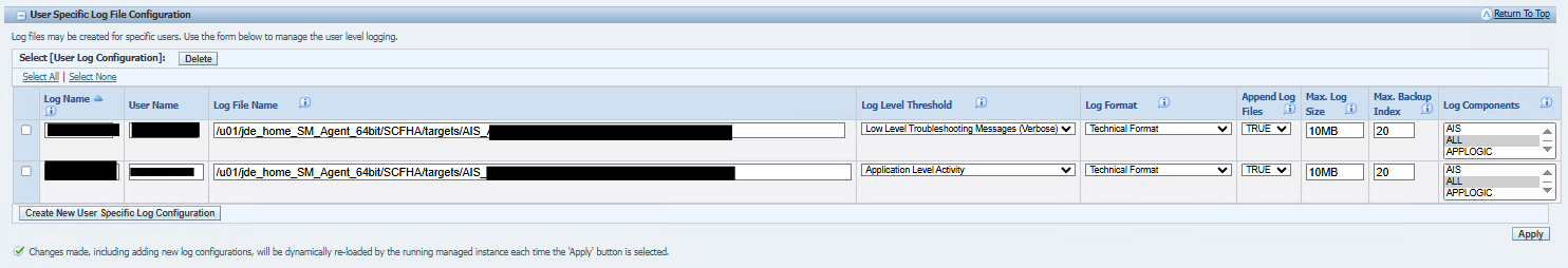

- In the Log File Configuration screen click on Create New User Specific Log Configuration and you will be prompted for a user name.
- Enter the JDE user ID you want to log and an entry will be added to the User Specific Log File Configuration list. Update the Log Level Threshold as required and click on Apply to start logging.
