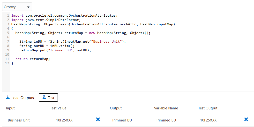

Re: [Orch] issue with orchestration using business unit as an input due to the space in front
Hi Nicolas
I would approach this by having a Custom script or Logic Extension (if your TR version has them) that takes in the BU from the orchestration parameters and trims the BU. The screenshot below shows a Custom script that will do this:
You can then map the "Trimmed BU" output value into your rule.
Hope this helps
Jonathan
