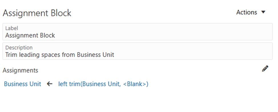

I believe 9.2.7.2 logic extension has pre-set text functions one of which is to trim leading spaces. If so, you can create a logic extension and add an assignment block, similar to the one below, before passing it to the rule.
Re: [Orch] issue with orchestration using business unit as an input due to the space in front
Hi Nicolas
I would approach this by having a Custom script or Logic Extension (if your TR version has them) that takes in the BU from the orchestration parameters and trims the BU. The screenshot below shows a Custom script that will do this:
You can then map the "Trimmed BU" output value into your rule.
Hope this helps
Jonathan
