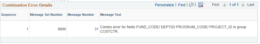

Re: how to fix error message "accounting distribution for the prepaid is not valid."
Actually, error message is because of the Combo Error. Please advise how to fix that..
