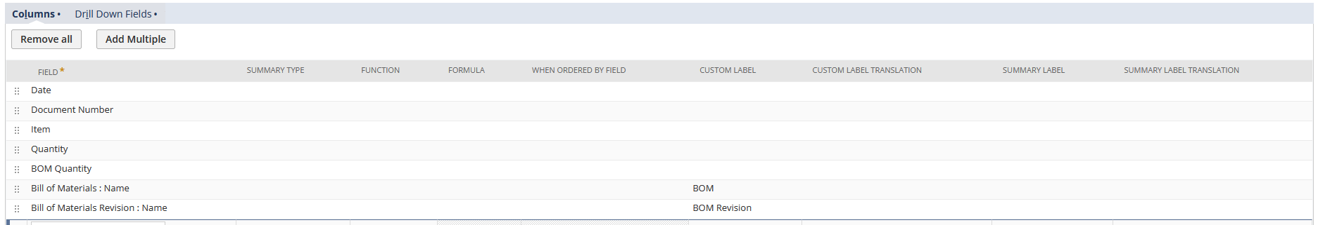

Results tab:
  • Date
  • Document Number
  • Item
  • Quantity
  • BOM Quantity
  • Bill of Materials; Name
  • Bill of Materials Revision: Name
Note: You can add/remove columns as necessary.
