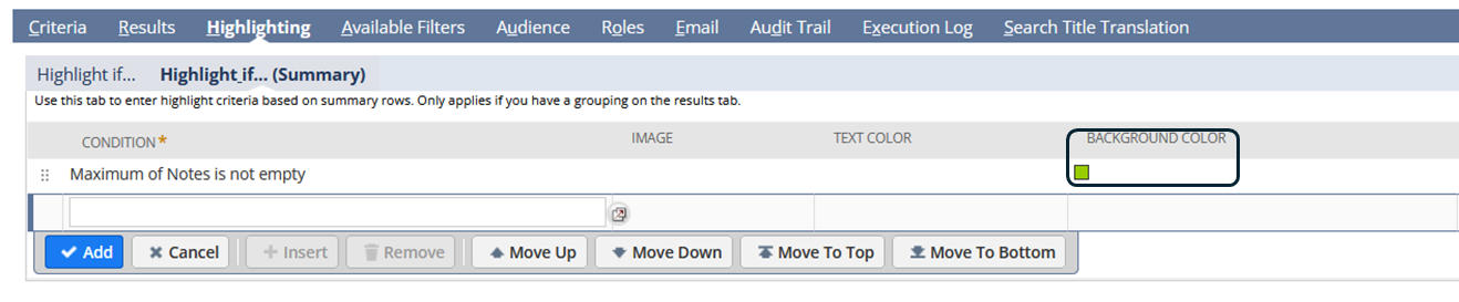

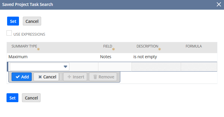

4.) Go to Highlighting tab > Highlight If (Summary):
Add the condition:
Summary Type: Maximum
Field: Notes
Description: Not Empty
Assign a background color
