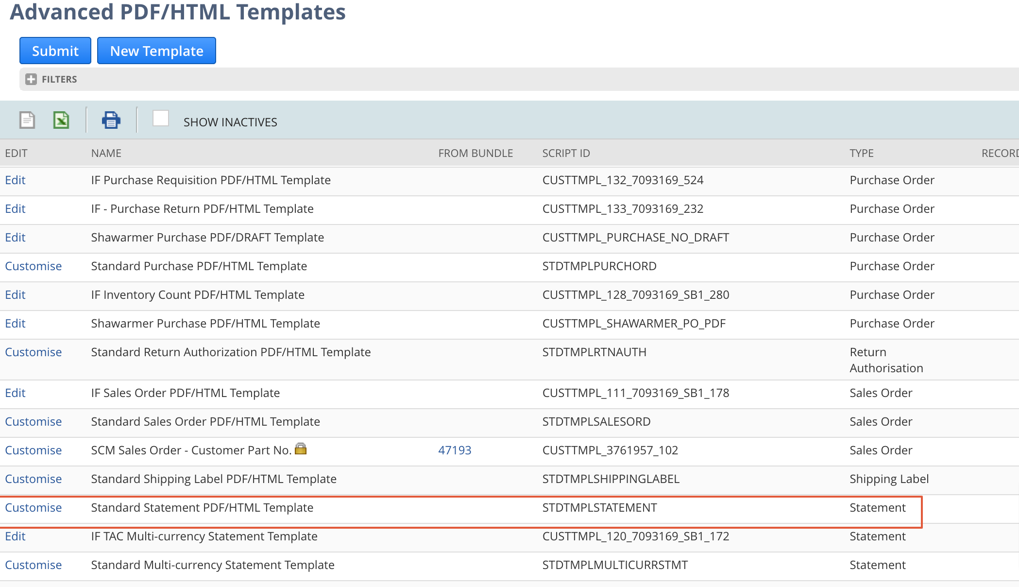

Hello @KNason76 ,
Yes, It's possible to add a customer ID/number in a custom AR Statement.
Goto Customization - Forms - Advanced PDF/HTML Template
Select customer statement and do the required changes using the customization
