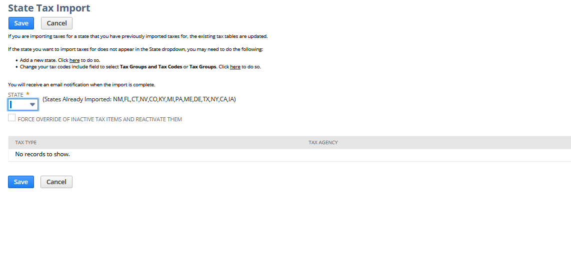

It is possible that the Tax Code are generated from the Use Sales Tax Table:
In this page, users can import tax code for different states. You can check SuiteAnswers Id: 8045 | Importing the State Sales Tax Table

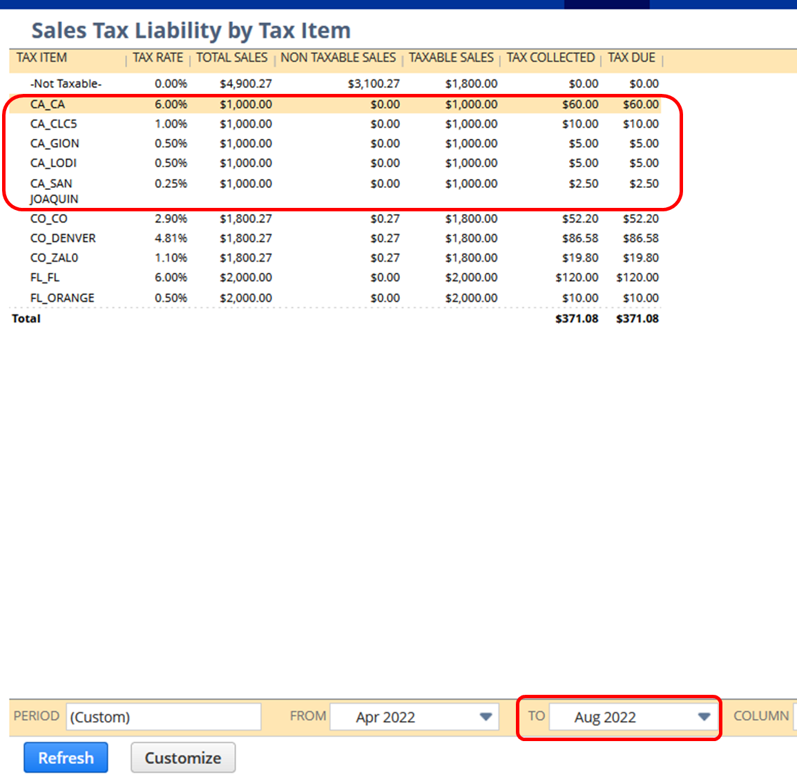

For the Tax Due in your report, could you double check again the period set in the filter of the Sales Tax Liability by Tax Item? Can you try to make it to the your most current period?
Normally, the Tax Due is updated upon the Payment of Sales Tax's posting period. Here is an example:

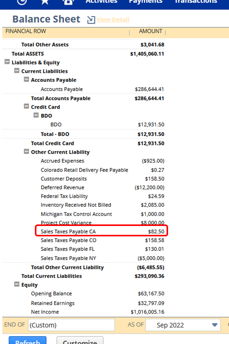

As of August 2022, I have this Tax Due for California. Which is also the same with my Balance Sheet

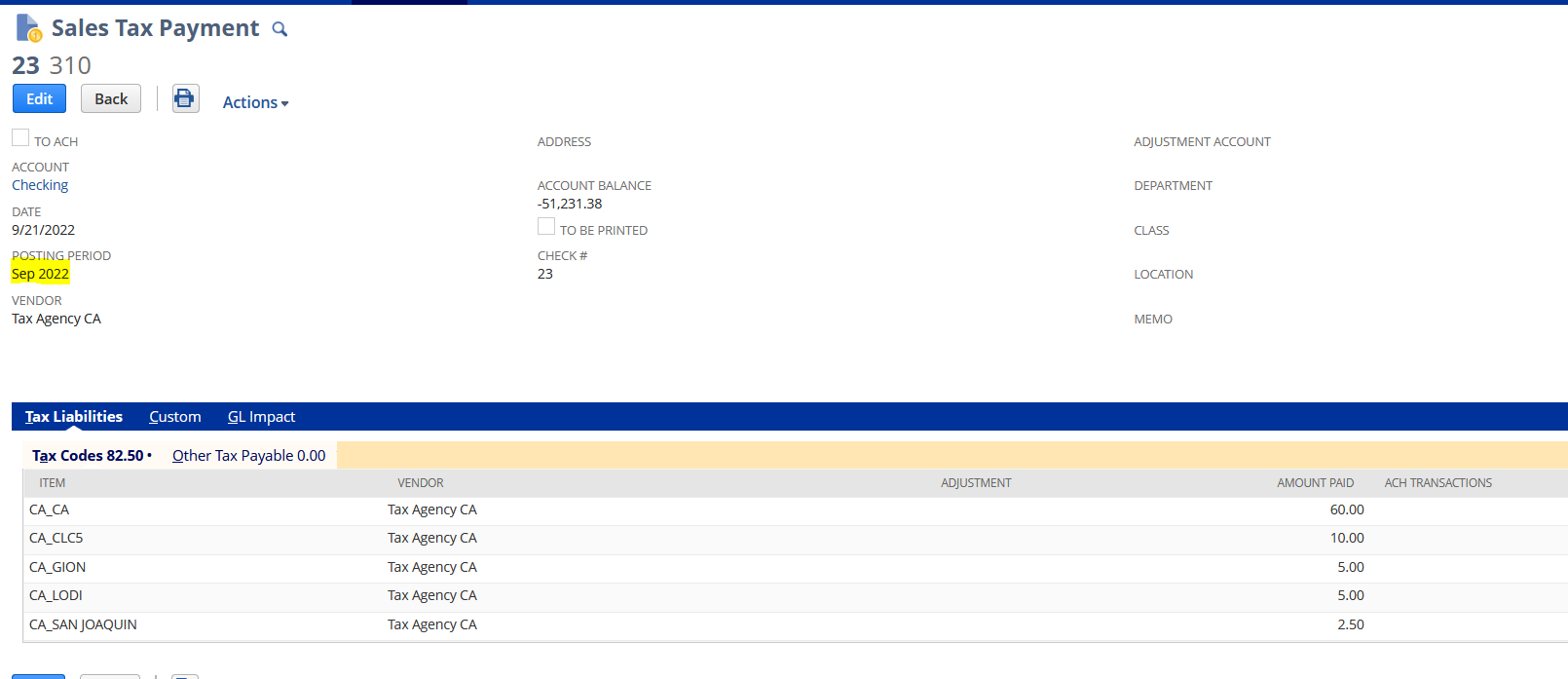

Then in September 2022, I made a Tax Payment:

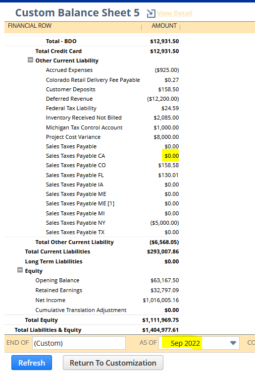

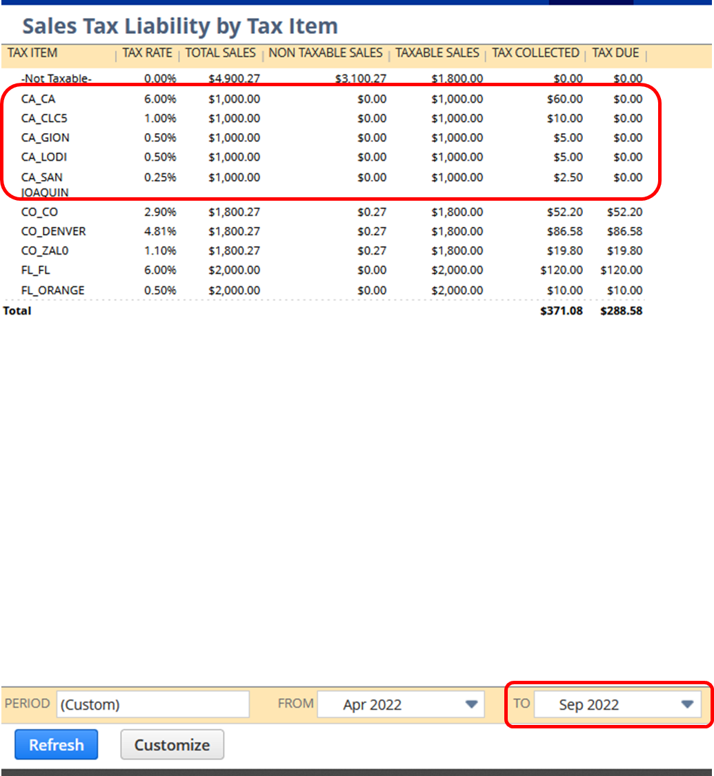

So when I set the Sales Tax Liability by Sep 2022, the Tax Due is zero since I have already paid it:
Thus also in my Balance Sheet as of Sep 2022, the Sales Tax payable for California is empty
To view your Tax Payments made, you can go to Transactions>Bank>Pay Sales Tax>List
