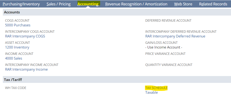

As stated in SuiteAnswer ID: 92061 Hierarchy the System is Using When Selecting Tax Codes on Vendor Bills, the following is the Items (Hierarchy) in selecting tax code in Bills:
1. Tax Code that is specified on the Subsidiaries tab of the Vendor record.

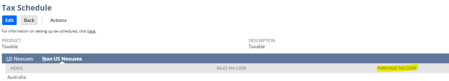

2. If none, the system will use the Purchase Tax Code set in the Non-US Nexuses tab of the Tax Schedule associated to item.
3. If none, the system will use the
