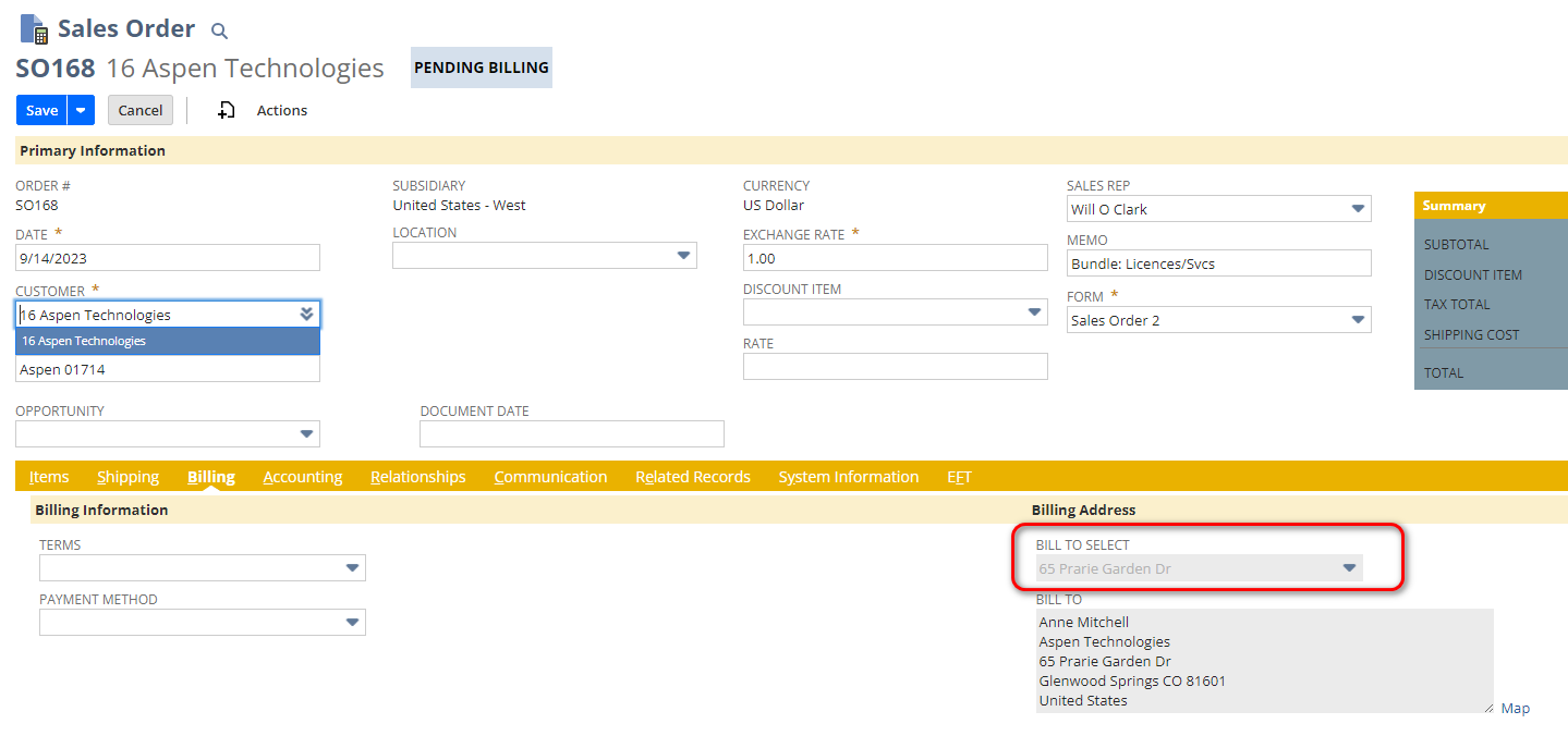

Re: Prevent Certain Roles/Users from Changing Bill To Address
Hi @jmack_admin
The "Bill to Select" field is not visible in the workflow, which might be a limitation in NetSuite. Perhaps @Veronica Steluta Mincior-Oracle can provide more insight on this.
Apart from that, you could try creating another sales order form which is a copy of current form and setting it as the default for your operations team. Then, you can disable the "Bill to Select" field at the form level.
