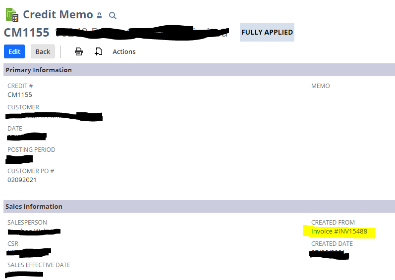

Hello @Javier P. ,
We occasionally issued credit memo under the circumstance you mentioned. What we do is setting up an "Other Charge" item with proper G/L accounts (suggest to consult with the accounting team for this).

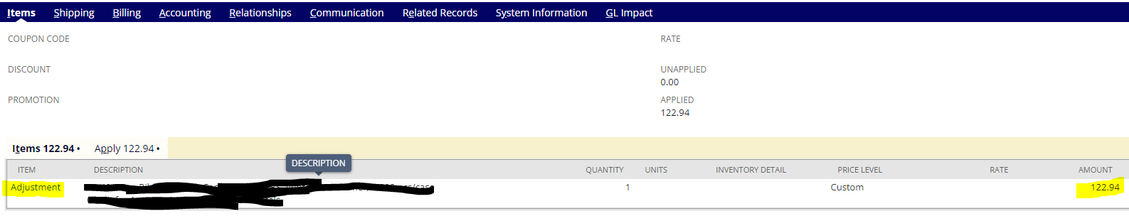

We set up an "Adjustment" item and use that for non-inventory related transaction. Below is a screenshot of what the credit memo would look like using the item code:

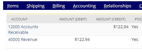

Below is the G/L impact for the above transaction. The G/L impact could vary depending on the item setup.
Hope the above helps.
