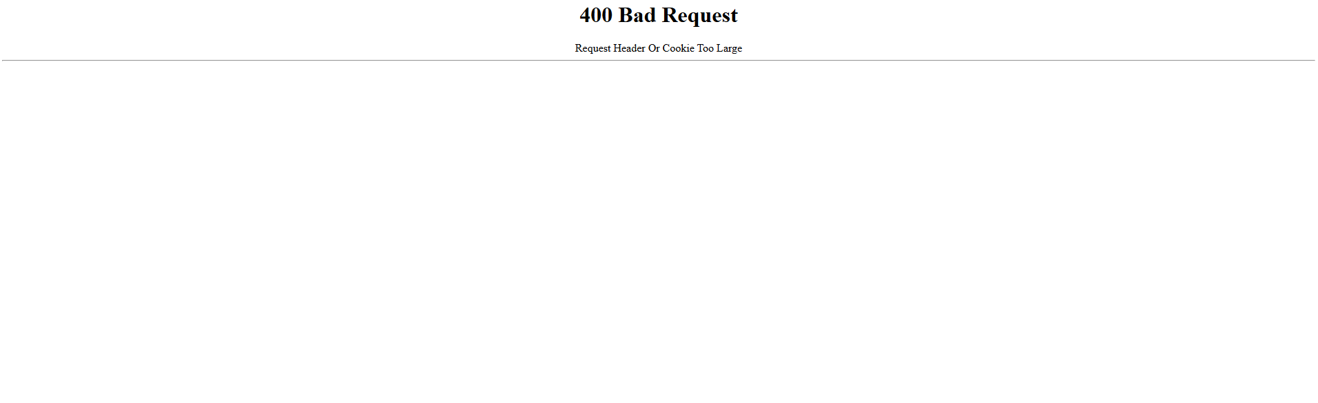

If you are receiving the 400 - Bad Request (request header or cookie too large) when attempting to log in via Chrome, try another browser.
Re: New NetSuite Certifications
Just received the same error when I tried to login to CertView using Chrome:
Good news is that I was able to login using Firefox. 😊
