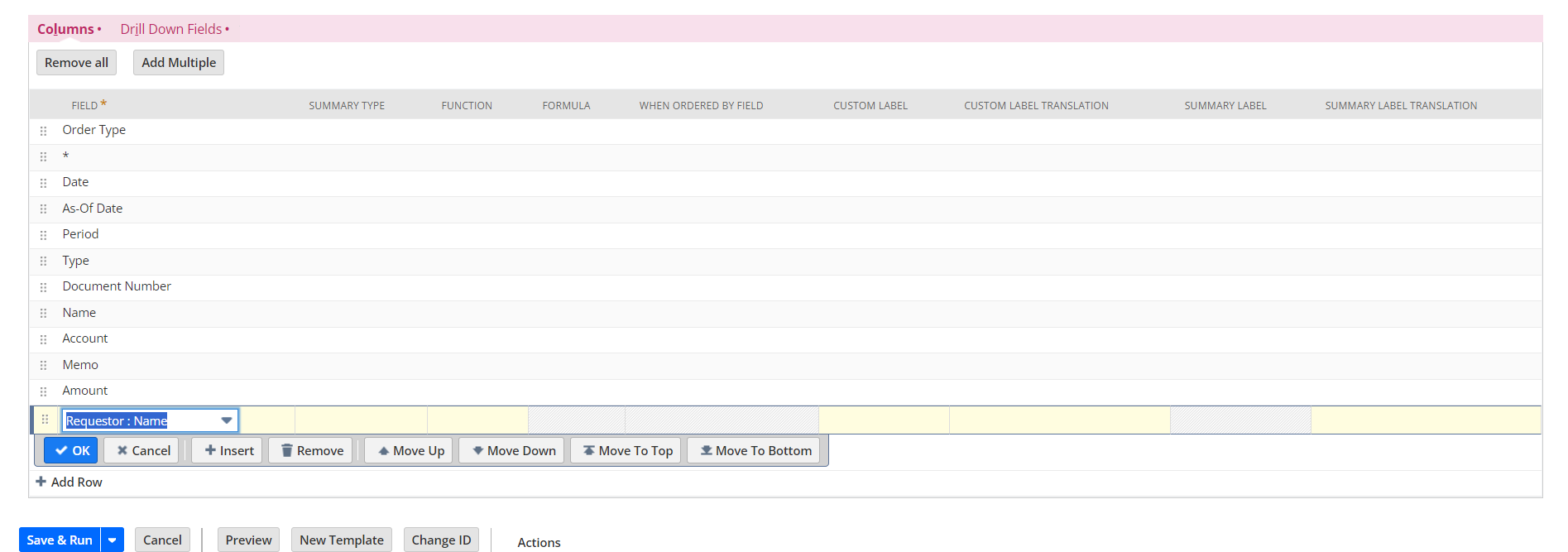

Hello @Dext3r,
I have a Transaction Saved Search for Purchase Order on our end by using our standard test account. To pull up the Employee name on the Saved Search results, please follow the steps bellow:
- Edit your Saved Search.
- Under the Results tab, add the Requestor Fields... and select Name from the dropdown list.
- Click Save & Run.
Let me know if this will work on your end :)
