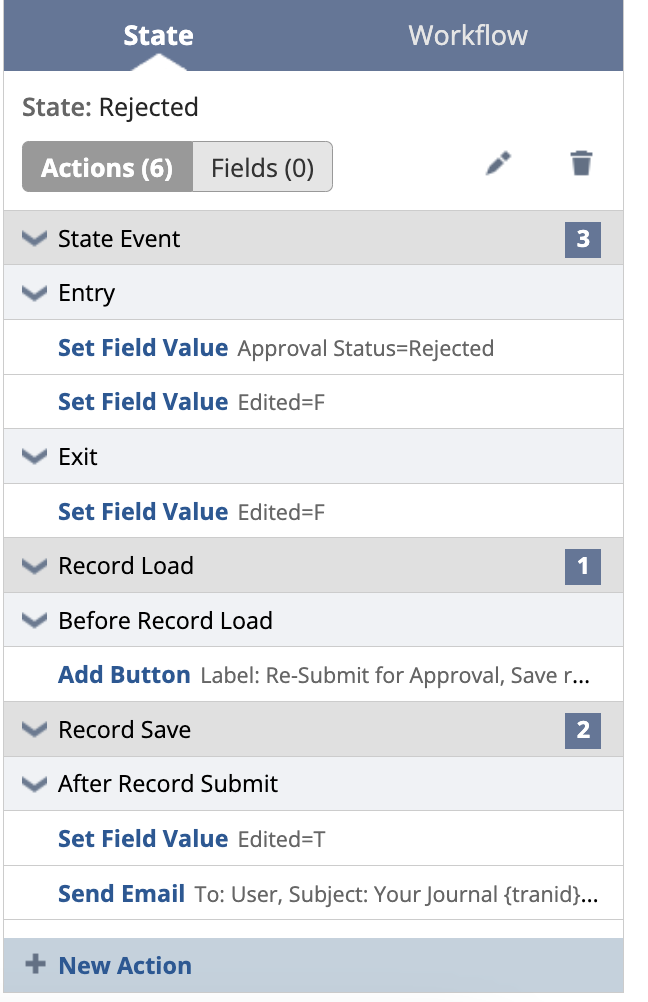

Cracked the solution: Below are steps to execute —>
- Add a checkbox to the journal entry called “has been edited”
- Add a set field value on entry into rejected state to set the “has been edited” checkbox to UNCHECKED
- In the add button action add a condition of “has been edited” = T
- Add a set field value action that sets has been edited to CHECKED after record submit when the event type is editChange your transition to only execute on button “re-submit”
- Add another set field value action on Exit that set “has been edited” to UNCHECKED.
