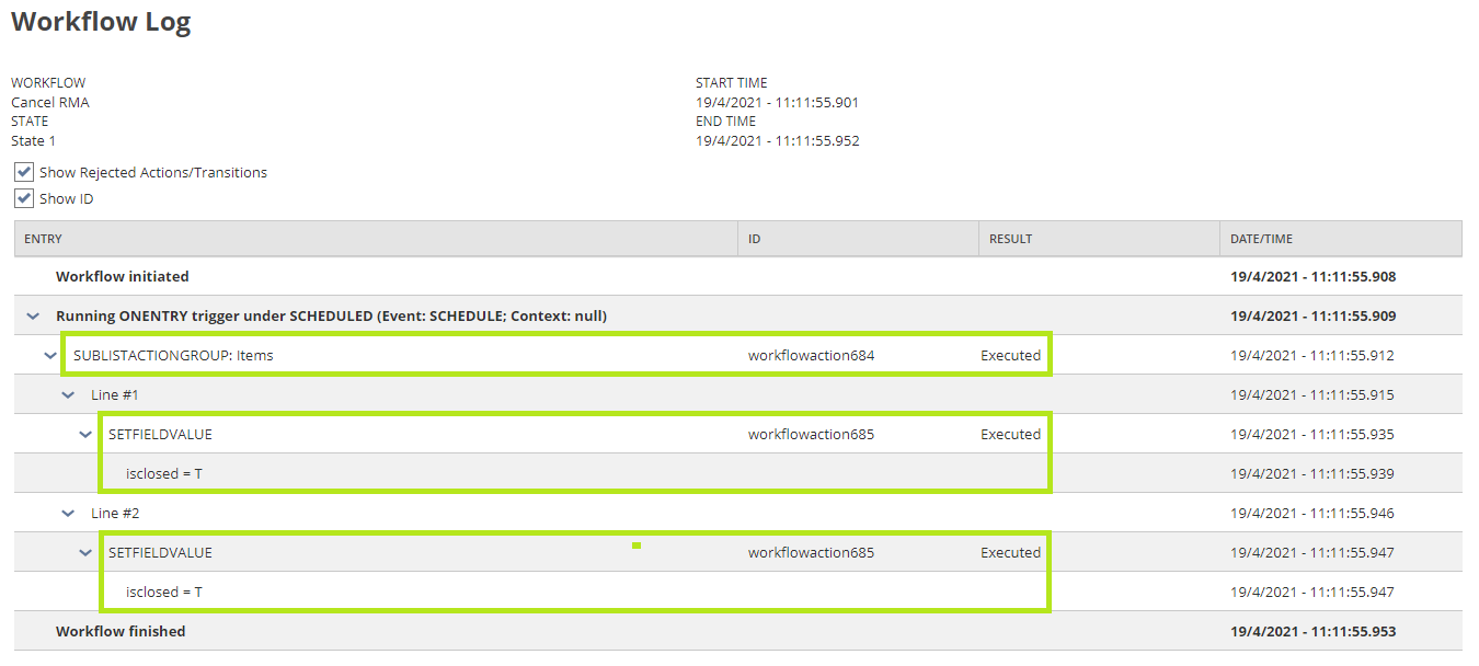

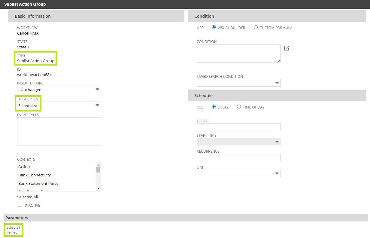

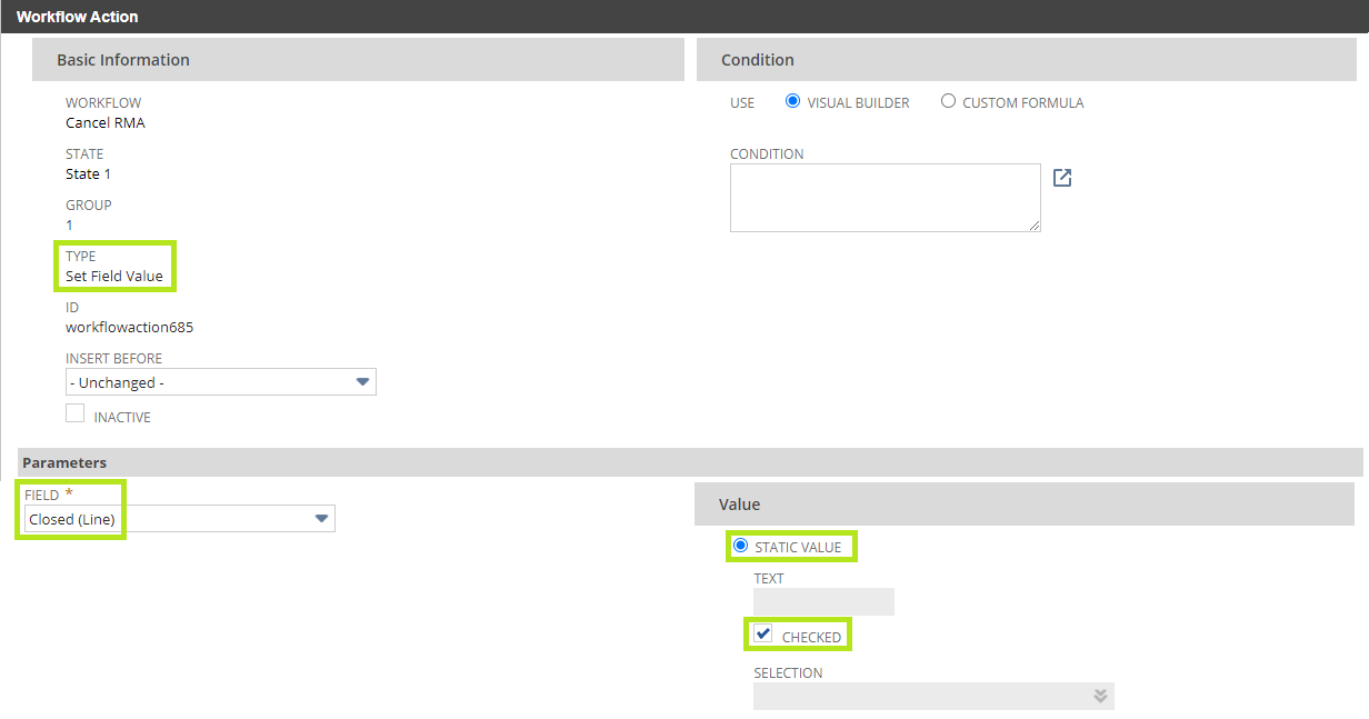

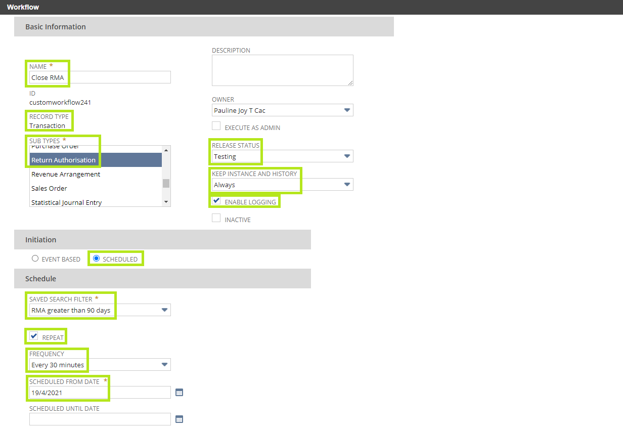

I was able to set the status to Closed for return authorization records that are more than 90 days on Pending Approval status. Here's the workflow setup on my end you may use as guide:

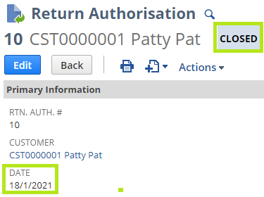

Each line item must be closed for the whole record to be set to Closed. Here's one of the return authorization records pulled by the saved search filter:
You can test the how the workflow will execute on a few records when Release Status is set to Testing. Click the Execute Now button on workflow setup page to run the workflow on the first 20 records returned by the saved search. You may, then, change the Release Status to Released after testing the suggested solution.
