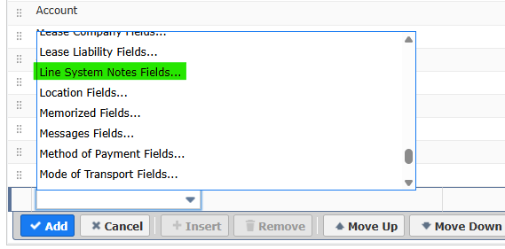

Re: Transaction - Line Level Systems Notes
@ABDUL HANNAN , on a "Transaction" saved search, on the results columns, this is the join that gives you the line level audit trail that @Tigran Shahnazaryan is referring to.
