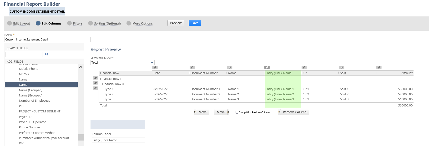

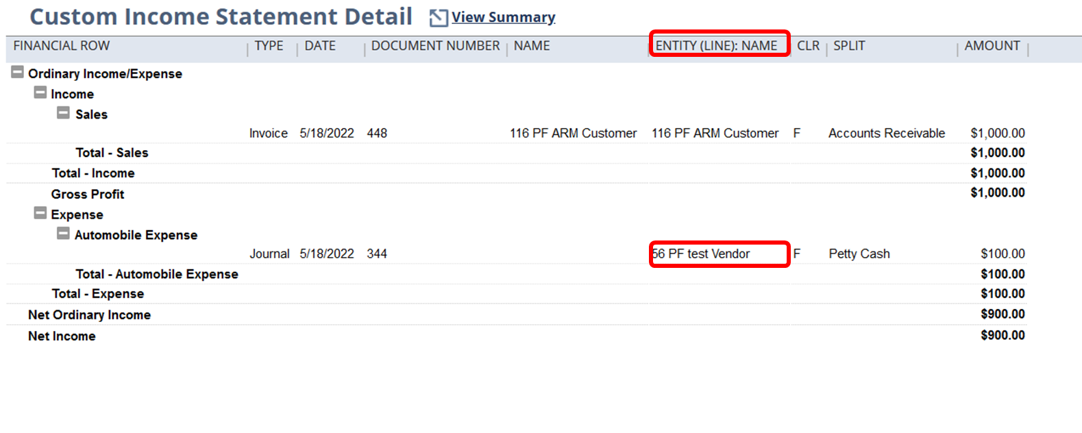

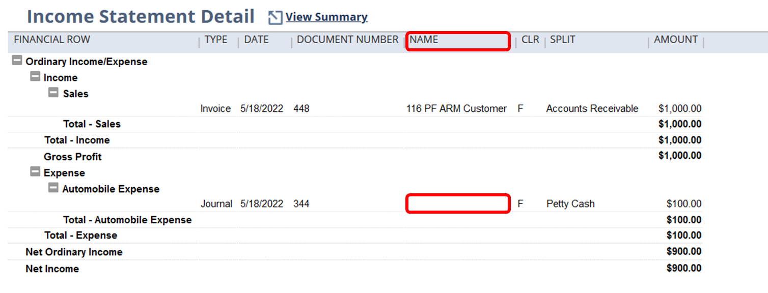

NSC | Show Entity (Customers/Vendors) from a Journal Entry in an Income Statement Detail
Scenario:
By default, the Name column found in the Income Statement detail refers to the Entity (Vendor/Customer) found in the header of the document itself such as Invoices, Vendor bills etc., not the actual G/L line so that is why, the name column is empty for journal entries with a customer or vendor:
Solution:
To be able to show the Vendor lines of a Journal Entry in an Income Statement details, users needs to follow the steps below:
1.) Navigate to Reports > Financial > Income Statement > Detail
2.) Click Customize
3.) Go to Edit Columns
4.) Open Financial folder > Entity (line) subfolder > select Name
5.) Save and run the report
Have you tried this one?
Hope this helps
