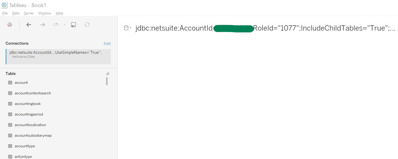

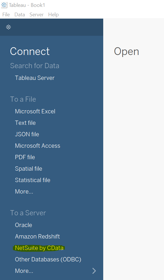

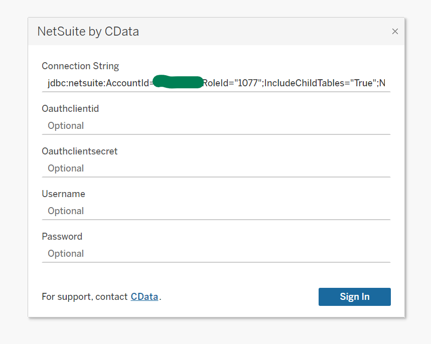

Totally understand. And agreed - As I mentioned above... I can test connect successfully from every other ODBC based query tool. IE: ODBC via PowerBI, Excel, Microsoft Access, etc. etc.
However, when one pays for a Tableau license, which is advertised to include an integrated connector for Oracle NetSuite... I'd expect it to work without having to setup my own connection via the ODBC setup. Seeing as I'm after high speed meta, real time access and enhanced SQL-92 based meta discovery. (We transact north of $X Billion, so I'm sure you can imagine the data I need to dive into and trying to do it via SuiteTalk or ODBC)
As you can see here and here:
It should be as simple as "click and go"; which isn't quite the case.
However, I have figured out a definitive solution. For anyone having issues connecting, please feel free to reach out.
