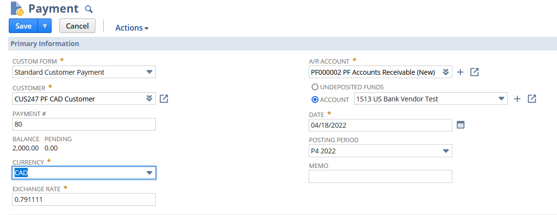

2.) Navigate to Transactions > Customers > Accept Customer Payment
3.) Select your Customer and Currency
4.) Create Customer Payment
Go to Invoices Subtab and click apply checkbox beside the Journal/s:
Go to Credits subtab and click apply:
5.) Click Save

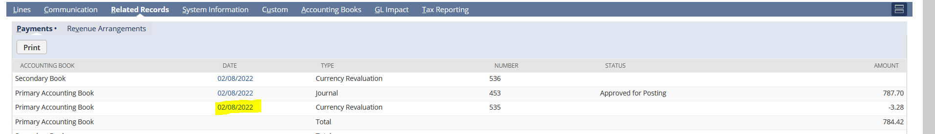

If you check the related records of the Debit Journal/s you will be able to see currency revaluation and applying JE:

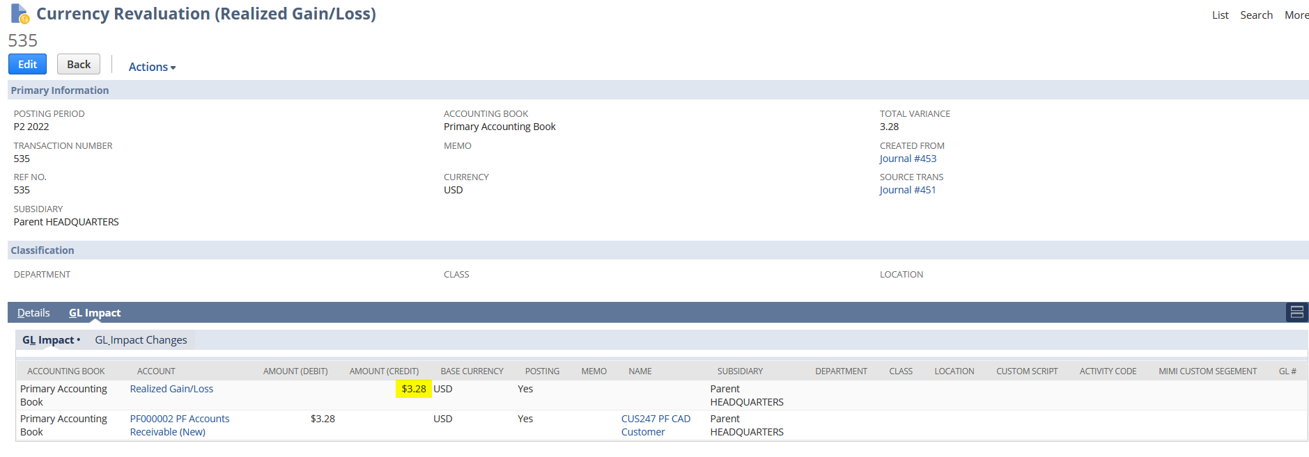

When checking the Currency Revaluation, you will now be able to check the Realized Gain/Loss transaction which is not reversed next period:
Upon checking, the results will zero-out the A/R aging report, as observed in my test account, and no Unrealized Gain/Loss will be Generated.

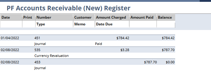

Per checking it was zeroed out in the Account Register and the Journal Entry was marked paid:
