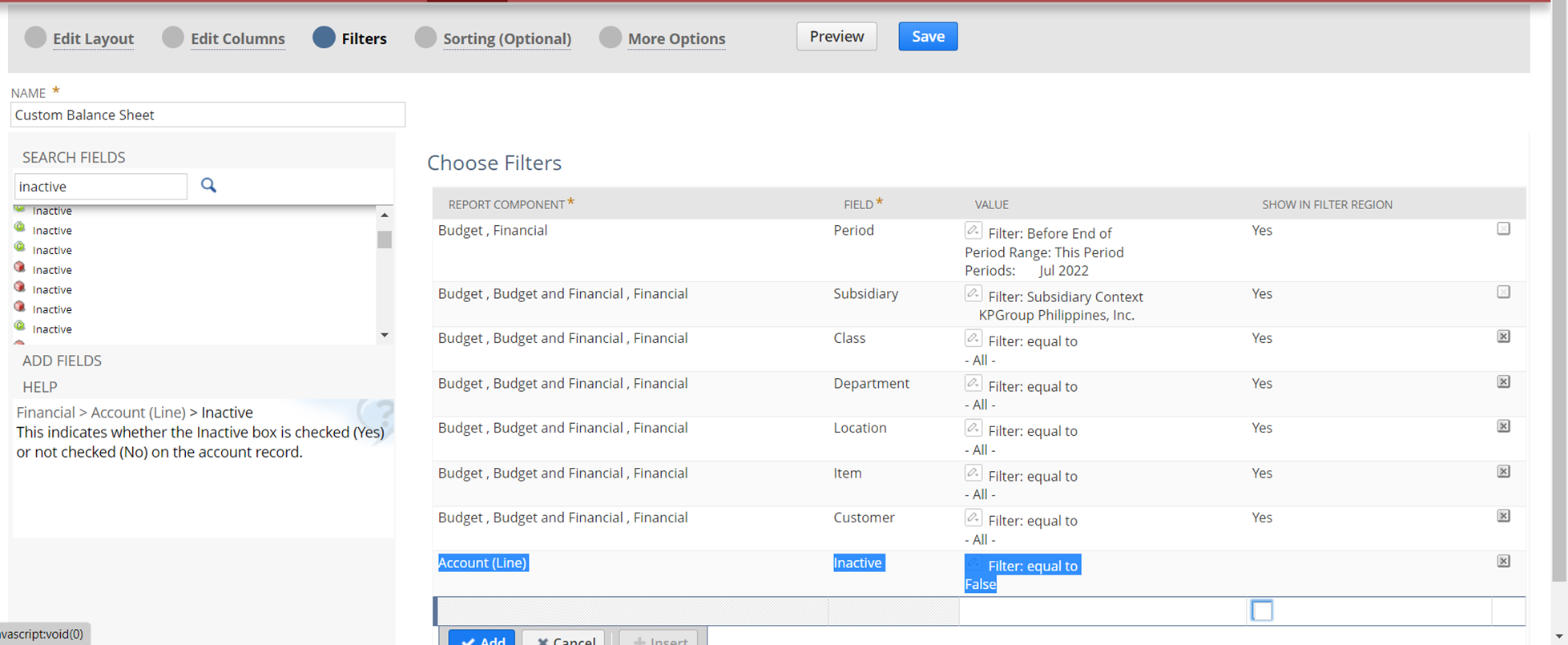

Re: How to eliminate inactive accounts from BS and PL report which SHOW ZEROS.
Good day. Did you try to edit the filter on the report and select the filter for inactive? Please refer to image below.

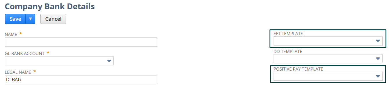

Re: Positive Pay
No worries, @User_XQ321. ?
I also checked that it is possible to use same bank account for EFT and Positive Pay. Note that when setting up Company Bank Details, you will use two different templates for EFT and Positive Pay.
I also asked if there's a different Bundle associated to SFTP as this might not be compatible with our EFT Bundle or you might create two Positive Pay records/transactions.
