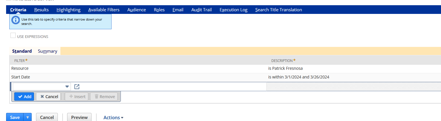

1.) Navigate to Lists > Search > Saved Searches > New
2.) In the Criteria, you can add:
The Resource Name
The Start Date

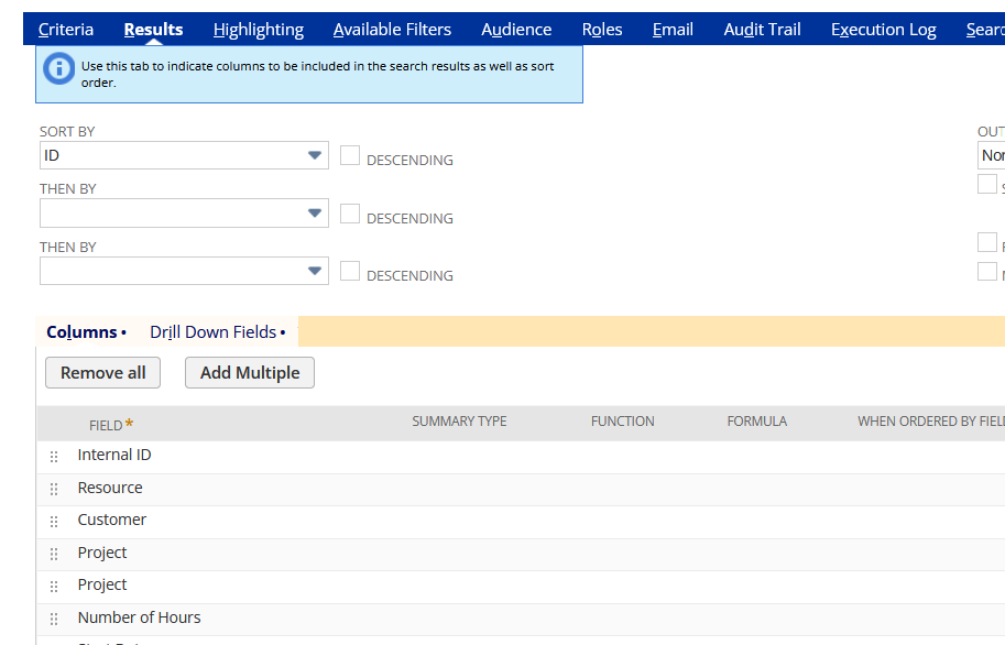

3.) In the results tab, you can add the Internal Id as reference for your existing Resource Allocation:

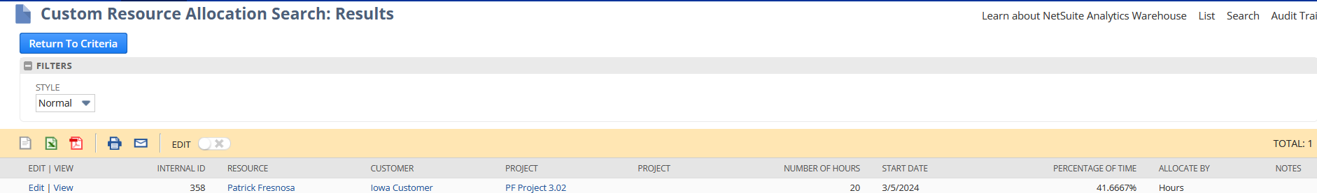

4.) Save and run
Each resource allocation has its own unique internal id and project.
