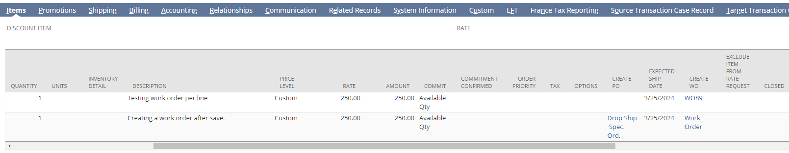

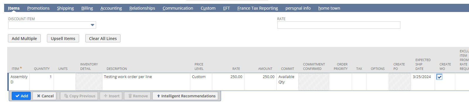

You can absolutely tie many work orders to a single sales order, if you associate the work orders to the line items. For each Assembly you sell, for example, you can tie the work order needed to build the assembly to each line.
As an administrator, if you open a new sales order record and change the form to 'standard sales order' and save, you should see the Work Order field on any line with an assembly. When you add the assembly item to the line, you can check the 'create work order' box, and (as long as the assembly has a bom) when you save the Sales Order a work order will be created automatically.
Here you can see the single work order created automatically

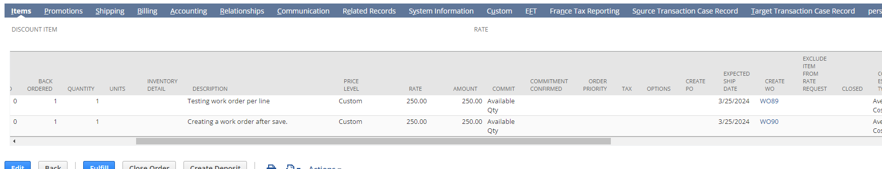

When you view the sales order, you can see the work order tied to the line.
In the image above, I added a second assembly to the sales order, but did not click the checkbox 'Create work order'. I can still associate a work order to this line by clicking the 'work order' hyperlink, saving the work order manually, and Voila! a different work order referenced on each line.
