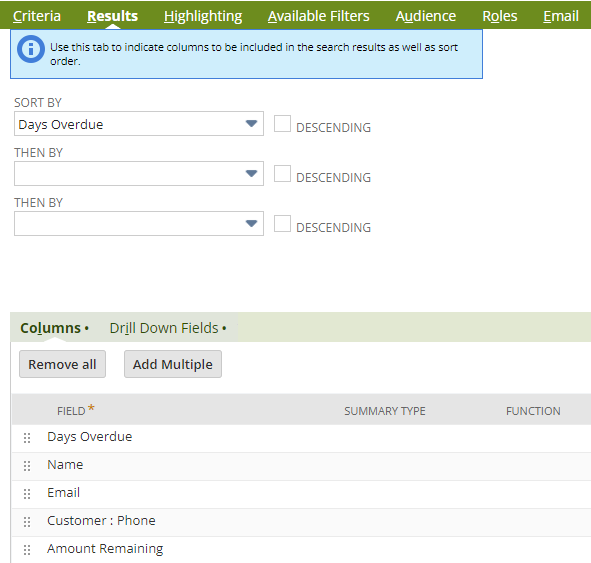

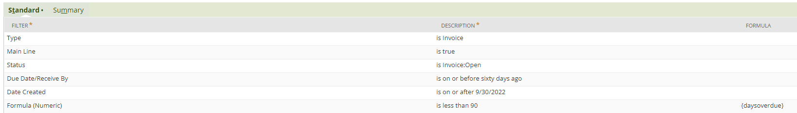

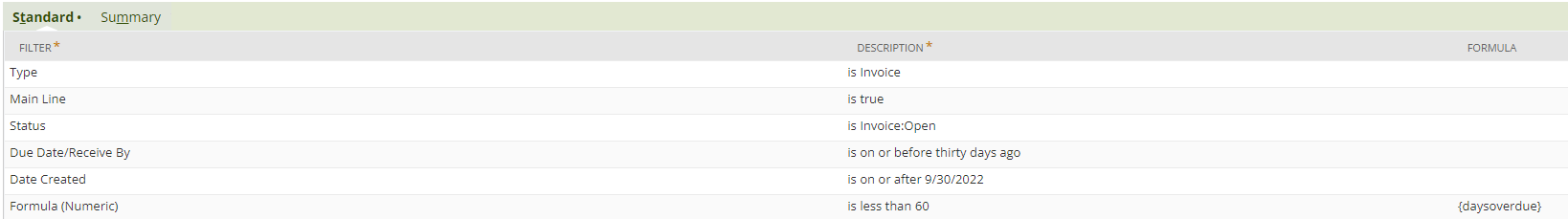

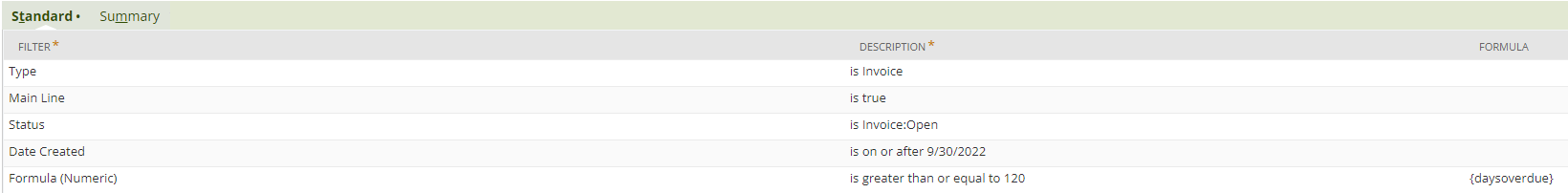

Hello @Jeremy Guimaras -Oracle thank you so much for the quick updates and follow up, very appreciated, it is helpful, with that reference, we tried with different ways, finally got the output as expected, please check on the below screenshots for reference,
Using below criteria we get the invoices with 30 days past due,
Using below criteria we get the invoices with 60 days past due,

Using below criteria we get the invoices with 120 days past due,
In the results tab pulling below information,
Hope it will be helpful for the ones who are looking for past 30, 60, 90 and 120 days invoices with the past due,
Actually this was queried by one of my friend, I shared him the ideas to achieve the solution with your reference, now he is fully happy with it and got what he expected, once again thank you @Jeremy Guimaras -Oracle , thanks to my friend as well who given me the screenshot to post it here so that it is helpful to others in our group,
