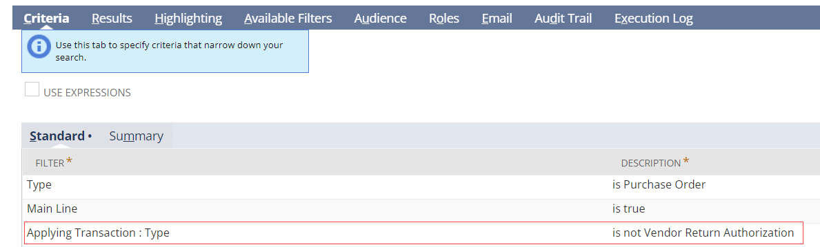

Re: In a Saved Search can I filter Purchase Orders that have a Vendor Return Authorization
Hey @Dustin S,
Vendor Return Authorizations are linked to Purchase Orders via the "Applying Transaction" join. If you enter this criteria, the POs with Vendor Return Authorizations will be excluded:
