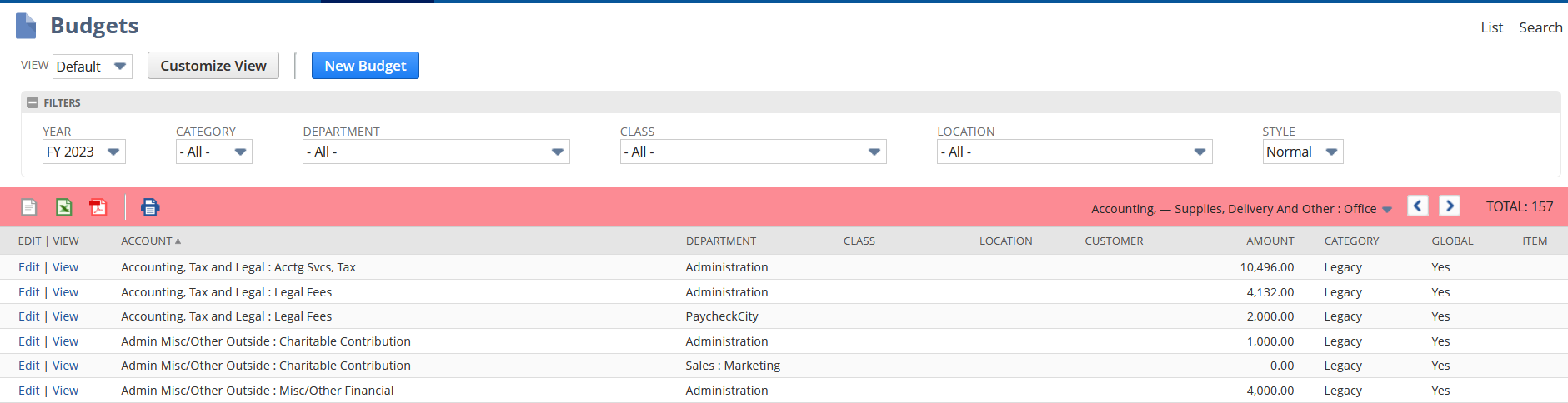

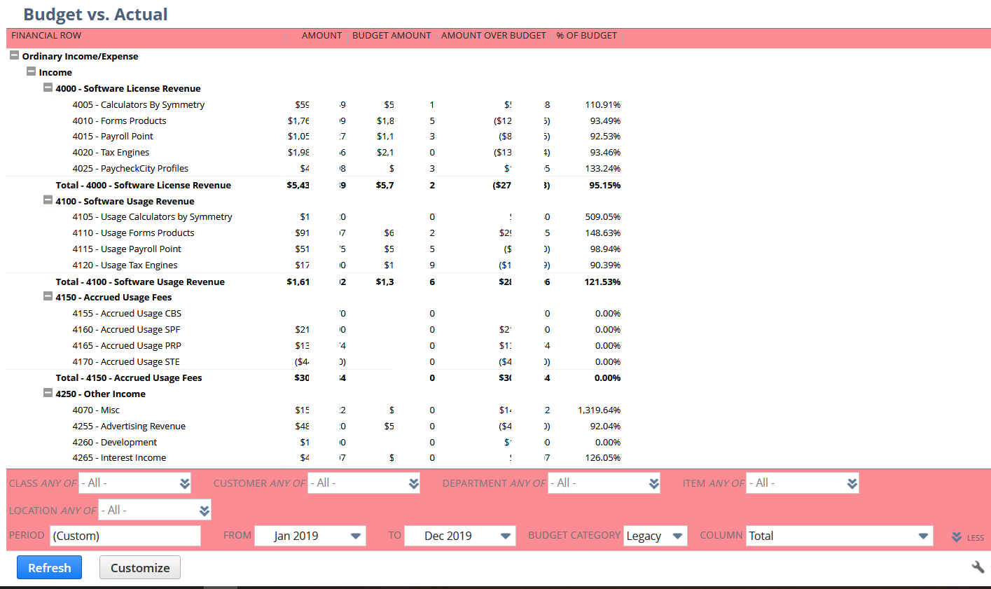

Just to set the stage: Our implementation is for NetSuite standard (not OneWorld). We do not license NetSuite Planning and Budgeting separately.
We leverage "Multiple Budgets" in SetUp>Company>Enable Features>Accounting>Advanced Features. (check or ask your administrator to see if you are entitled to it).
We then load a Budget by Budget Category for each year we are forecasting(as you can se we can Budget by Customer, Item, Class, Department, Location and Account Type)
There are some delivered Budget vs Actual Reports available.
We also leverage the ODBC connection to pull data into a SQL database for varied reporting.
Hope this gives you some ideas.
