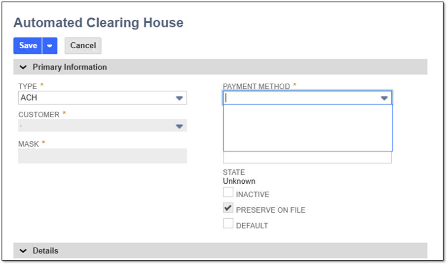

Adding a new Automated Clearing House (ACH) for a customer requires selecting a payment method, but in this case, no options are available in the dropdown list.
This is because no ACH payment method has been created yet. To set one up, follow the steps below:

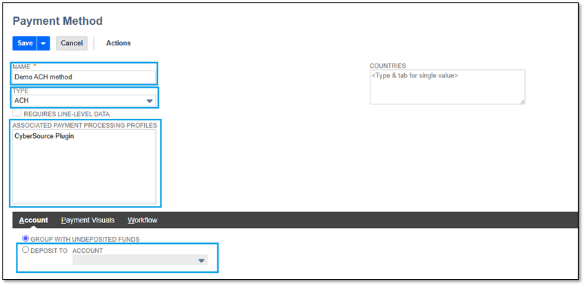

1. Navigate to Setup > Accounting > Accounting List > FILTERS Type = Payment Method
2. Click New button
3. In the form, populate Name for the Payment Method
4. Set Type field = ACH
5. Select the Associated Payment Processing Profile
6. Set the Account to deposit to.
7. Then Save

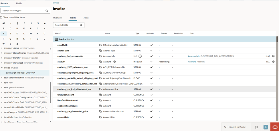

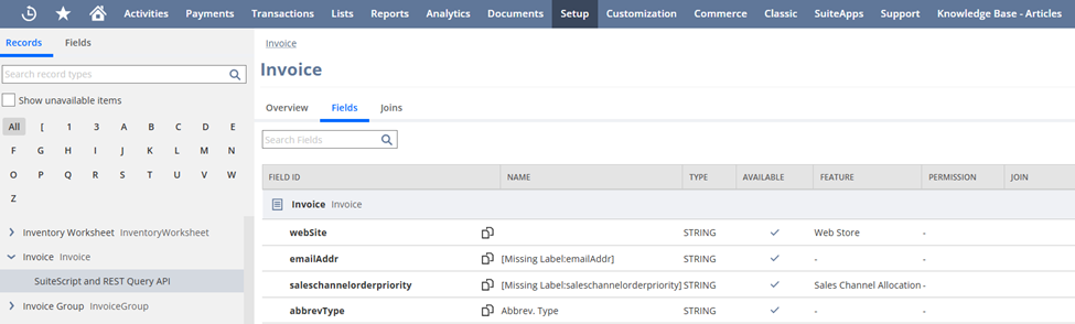

A user reports that the Invoice table appears as an unavailable item in the Records Catalog within their NetSuite account. Despite using the Administrator role, which typically has full access, the user is unable to access the Invoice table in this account.
Solution:
Enable Required Features

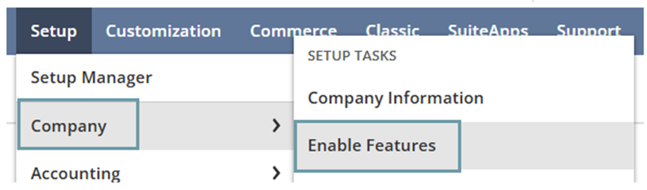

- NetSuite: Navigate to Setup > Company > Enable Features.
- NetSuite Next: Click Explore (Ask Oracle icon in the bottom right corner) button. In the menu, go to Setup > Company > Enable Features.
- In Accounting subtab > go to Basic Features section then confirm if A/R checkbox is enabled.
NetSuite:
NetSuite NEXT:
Even with Administrator access, record availability in the Records Catalog is influenced by enabled features and account configuration, not just role permissions. Ensuring the correct features are active is essential for accessing records like the Invoice table.
